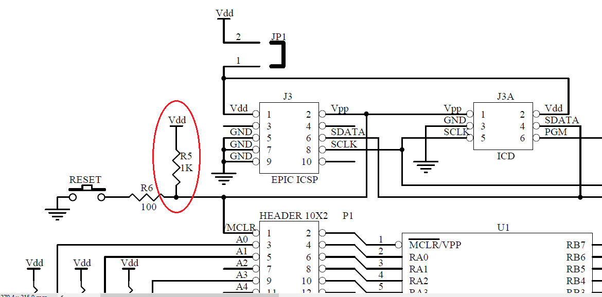

    At least I incorporated the pull-up resistor
    What "pull-up resistor" is that? Is there something missing from the X1 board?

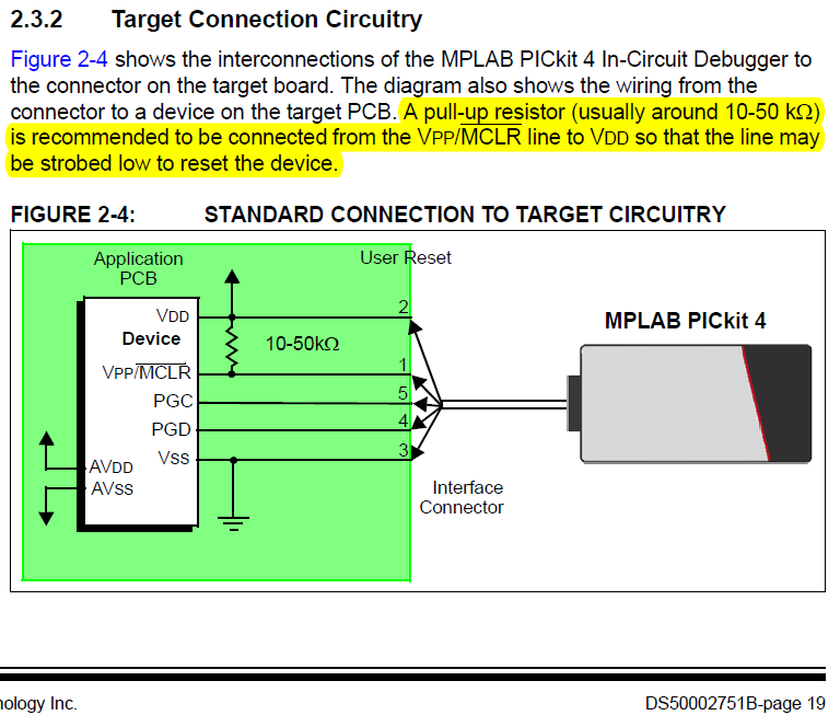

    The instructions seem a little vague, saying it can be configured for both ICSP and ICD. But it only mentions the pull-up in the ICD section.
    "The debugger system can be configured to use standard ICSP communication for both
    programming and debugging functions."
    So I hid one in the hotglue and the ICSP seems to run fine. The hotglue is not elegant, but it keeps all the fine wires separated and adds A LOT of strength to the connector.
    The pull-up on the Lab X1 is only 1K, the PK4 wants 10-50K. So I slapped in something in the 20K range; whichever one I had the most.
    The 1K probably might have been enough, but I'm getting enough pesky problems without creating more of my own.

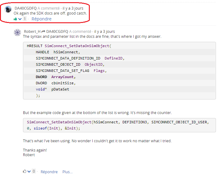

    Example of pesky problem: trying to get example code taken from the MSFS SDK docs to work. Except, the example code is missing a parameter.
    Took me a while to track down the problem. The DEVs were really helpful though. Had a few of these pesky problems since I started this project.

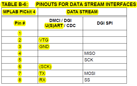

    The PIC ICSP and debug connections are the same. In Table B-5, ignore the "debug" column (that's not for a PIC device) and just use the ICSP column connections.
    Whatever you add externally to the VPP/MCLR is just going to go in parallel with the 1K on the X1 board (lowering the R), so I'd remove it.
    Do you have the JP1 jumper installed? If you tell the PK to use target power then it must be connected as it uses the target VDD connection to power the output drivers of the ICSP lines.
    Yeah, I realized that after I posted that pic and started googling those acronyms.
    Quote Originally Posted by tumbleweed
    Having 1K in parallel with 20K shouldn<t have an impact when the allowable range is 10-50K, I would think.
    Yup, JP1 is ON, I use an external power supply for the Lab X1. I have a fear of overloading USB ports on my PCs, practically a phobia.
    You might want to rethink that. What's 1K in parallel with 20K?
    Although to be honest, I've used 1K before without too many issues.

    Get rid off the 1K resistor. LABX1 was on a very safe side with this value and with 20K in parallel you are now less than 1K.

    Wouldn't it be better to just change the 1K to a 10K on the X1 and get rid of the extra resistor in the cable?
    That way you still have the MCLR pullup on the board.

    Robert said he had 20k in parallel with 1K. So a 20K I think is just fine.

    I've put aside my UART device, and finished my programming cable for my Lab X1 board (parts finally came in). It was getting annoying switching the PIC from ZIF to Lab X1 all the time.
    Attachment 9363
    Guess what happens when you scroll to the very next page of the PK4 documentation?
    4,184
    Default Re: ICD and USB UART device
    Well, seems you are hit by the RTFM thing!
