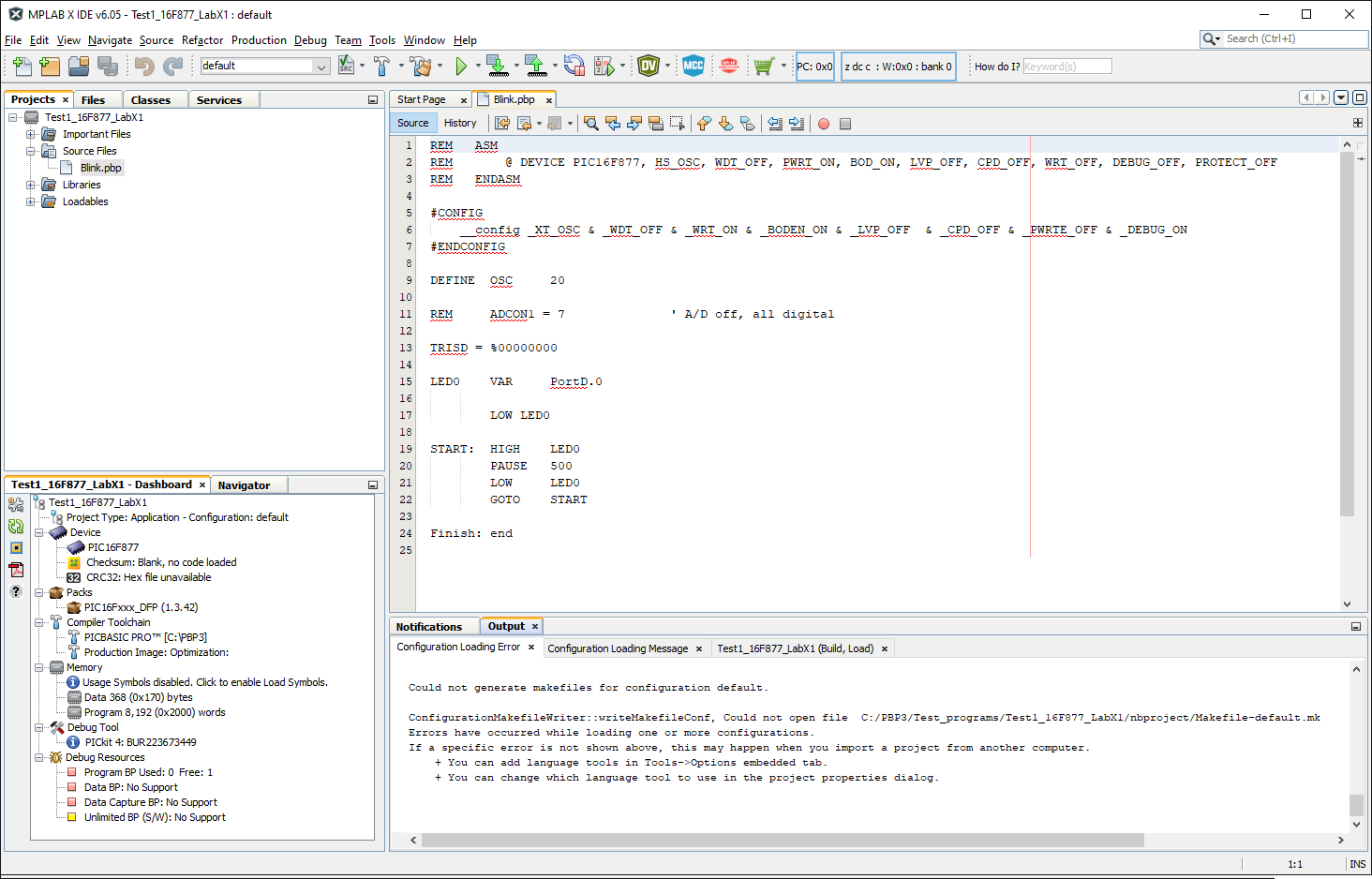

    Trying to get a simple program working using PBP3, MPLAB X with PICKIT4 and a 16F877 on the Lab X1, but keep getting:
    make -f nbproject/Makefile-default.mk SUBPROJECTS= .build-conf
    make[1]: Entering directory 'C:/PBP3/Test_programs/Test1_16F877_LabX1'
    make[1]: *** No rule to make target '.build-subprojects', needed by '.build-conf'. Stop.
    make: *** [.build-impl] Error 2
    make[1]: Leaving directory 'C:/PBP3/Test_programs/Test1_16F877_LabX1'
    nbproject/Makefile-impl.mk:39: recipe for target '.build-impl' failed
    BUILD FAILED (exit value 2, total time: 104ms)

    I converted ASM to CONFIG, but that didn't help. I've used that youtube video to include the compiler in MPLAB X, that went super well until I tried an example.
    Does our code have to sit in a special folder now?
    I read that PBP3 migration PDF, can't see what else I forgot. I'd really like to stick with MPLAB and not return to MCSP+.

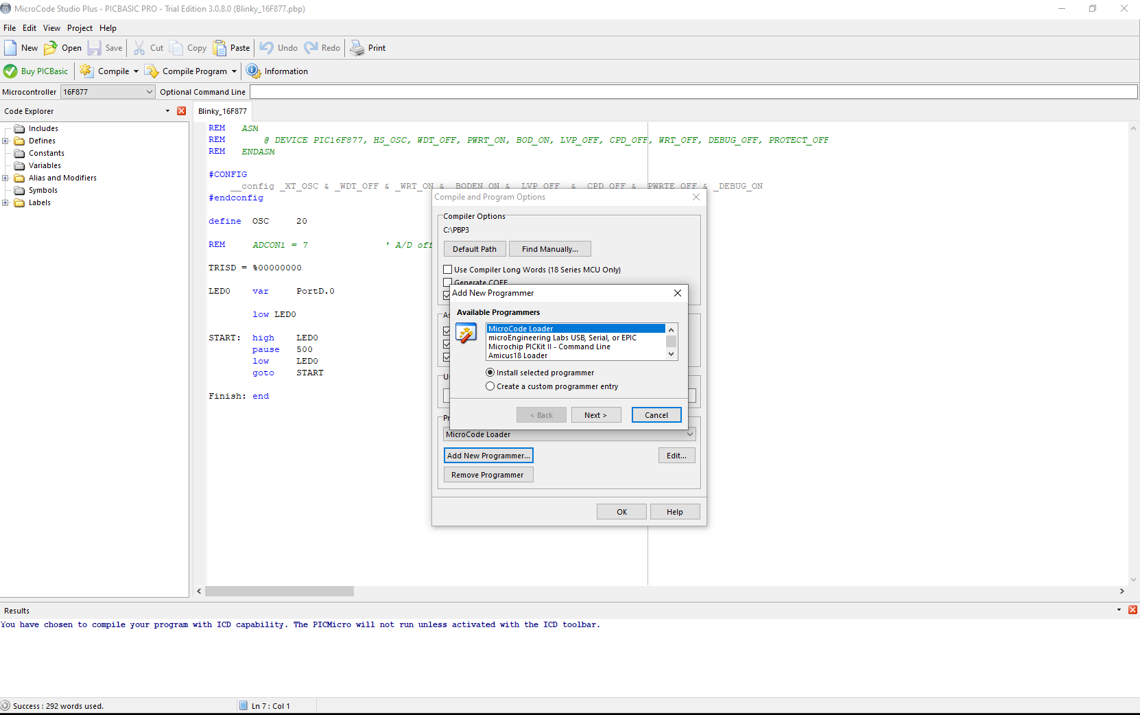

    Pic of the stuff on the left, and loading error.

    to the best of my knowledge the last mplabx that was pbp3 compliant was ver 2.35 [and just barely at that] , from ver 5.5 on
    mplabx no longer uses the mpasm [mpasmwin] assembler that pbp can only compile from
    Default Re: Stuck on first attempt using MPLAB X
    Then I don't get at all why we can select PBP3 as compiler without getting some sort of incompatibility warning...?

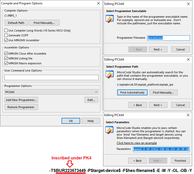

    I've added a custom programmer in MCS+5 using the instructions for IPECMD.EXE.
    I now compile and program in MCS+5. A black command box appears, everything seems normal, than FLASH, a message shows up for a millisecond about HEX FILE NOT FOUND (pretty sure that's what it says).
    Not sure what's going on, cause I delete all objects in my folder except the source right before I compile, just to make sure everything gets created. The HEX and ASM are right there, I opened them, they look "normal".
    The light stays blue on the PICkit4; it doesn't go red like when I tried with MPLAB IPE. I must be messing up my connection to the adapter board. I also remember reading about resistors and capacitors for the PK4, gotta find that again...
    UPDATE SOME MORE:
    I went back to update the command line to keep the command line window open like this.
    And I noticed that it's not letting me complete the EDIT process, the NEXT button doesn't come on, I must have missed that the first time around.
    So I deleted and created the custom programmer again and paid attention to the NEXT button.
    -TSBUR223673449 -P$target-device$ -F$hex-filename$ -E -M -Y -OL -OB
    Nope, NEXT button never comes on, and the command line seems complete if I EDIT the programmer again.
    Name:  PICkit4 custom pgmer B.png
    I compile and program again, I see HEX FILE NOT FOUND blink, and the command line window keeps closing despite the new command line.
    Via the PICKit3 programmer
    -TSBUR171738083 -P$target-device$ -F$hex-filename$ -E -M -Y -OL -OB

    I'm starting to think the command lines for the PK4 are different...?

    Still going nowhere in MCS+5; keep seeing HEX FILE MISSING before the command line window closes.
    Managed to program using MPLAB IPE, I just don't get any blinky action on my Lab X-1.

    Waiting for a reply from MeLabs forum to get the custom programmer working in MCS+5.
    Too many threads about the same topic.
    I just set up MPLABX 5.35, MCSP5, and installed the PICKit4 as a custom programmer.
    The only thing I changed was the commandline parameters
    -TPPK4 -P$target-device$ -F$hex-filename$  -W3.3 -E -M -Y -OL -OB
    (TPPK4=use generic tool PK4 instead of 'BUR serial no', W3.3=power target from PK4 @ 3.3V)

    Thanks for the ideas. You got me started playing with the command window directly, noticed differences by playing with parameter syntax.
    I've removed the ".X" suffix on the folder as well as replace a SPACE for an UNDERSCORE; just to be sure. I get identical results from the powershell window and MCS+5.
    I've also added the -W option; my PIC is not powered. It's on the MeLabs 8-40 pin ZIF adapter PCB.
    C:\MPLABX\v6.05\mplab_platform\mplab_ipe\ipecmd.exe -TSBUR223673449 -P16F877 -FK:\Project_v2\PBP\Test_1_16F877_Blinky\Blinky_16F877.HEX -E -M -OB -OL -OV -W -Y

    This is my final command line:
    -TSBUR223673449 -P$target-device$ -F$hex-filename$ -E -M -OB -OL -OV -W -Y
    Generic PK4 tool works just as well.
    -TPPK4 -P$target-device$ -F$hex-filename$ -E -M -OB -OL -OV -W -Y

    Couldn't even find my own thread on how to get PK4 working with MCS+ ... D'OH!
    I can't stress enough the importance of NO SPACES IN FOLDERNAME AND FILENAME.
    Here's a pic of how to set the programmer for those that are visual (like me):
