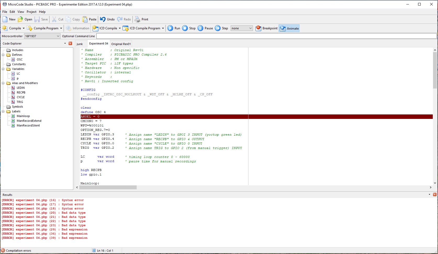

    I have been working with program for a number of days and suddenly this morning I get this compile error. I had also saved another version of that program earlier this morning, and that also fails now. It turns out any version that I save today has the problem. Does the Experimenter version have a cutoff date?

    i hope you don't expect much help posting pictures of code.
    there is every chance in that blurry pic that the config word is not correct for the chosen chip

    I have not changed anything in that part of the program for the last 50 revisions over a few days. If I take that line out, it objects to the next line, etc.

    you need to supply more information
    pbp version ?
    chip ?
    actual code not a blurry picture
    would a good start

    Uninstalled the compiler, downloaded a fresh Student edition and the problem is solved. Thanks for considering it anyway. (I can't help that this forum makes a blurry pic - https://www.picbasic.co.uk/forum/att...3&d=1679985701 )

    Are you sure you had the correct chip selected? I see a 16F1937 selected but that chip does not have ANSEL register.
    It has ANSELA, ANSELB and ANSELE.
    So the error message was correct!
