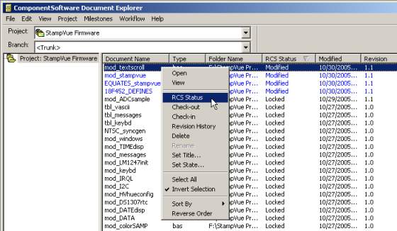

    Here's an overview on using CS-RSC:
    The best way to use it, especially for people like me that use multiple include files, is to define a project folder and move all your working files into it. This is done by using the CS-RCS Properties part of the program (I wont get into this too much here, because it is well covered in the help file).
    Once a project has been set-up and all the working folders are checked-in, the Document Explorer will now become your management tool for these files.
    <div style="float:left; padding-left: 225px;"><b>Document Explorer</b></div>
    <img src="http://www.picbasic.co.uk/forum/attachment.php?attachmentid=587&stc=1&d=1130783295 " style="clear: left;float: left; padding: 8px;">
    From this window (available on desktop) you can see any files that have changed within the project being highlighted in blue, and unchanged as black (changed files are files that have been modified and saved).
    To the far right is the version number assigned to the file the last time it was checked-in. Right click any file To obtain the Status, to Check-it-In, to Check-it-Out, to see the History of changes made, ect.
    The RCS Status option is rather cool. It allows you to open a "Differences" window that lets you see the actually changes that have occured to file. In the example below, can be seen the line-by-line modifications, with deletions shown as crossed out red colored text. And stuff that was added, is shown in blue text.

    To make this system really work well for you. It is important that you check-in files when you feel that you are at a stable or working version. Remember to do this before you go on to make additional changes, or to try out some new hack. This way if the changes really mess something up as Brian pointed out, you can always use the check-out feature to restore the file back to the last checked-in version. To help you analyze the multitude of checked-in versions that will inevitably accumulate, a note may be added to describe it, which can be seen by mousing over the file name (also available in the Revision Manager Window).
    !!! IMPORTANT !!!
    Only use check-out when you are certain that you no longer want the present un-checked in state of the file (the present working copy). Checking-out will over write it. If you are unsure about this, it is best to check-in the file, since you can always pull up a copy of any checked-in file you want.

    PicNaut:
    Do you keep all of your project's includes in the same folder as your .BAS or .PBP file?
    Yes I keep all the include files that the particular "project" requires in the same folder.
    Brian:
    Maybe I don't understand the problem but mytekcontrols' issue with not backing up include files seems a no brainer to me. I regard include files as a stable piece of code or compiler directives or whatever that was developed previously.
    Let me describe how I use include files and perhaps it will make more sense. As I develop a project, I first decide what are the basic things about the project that can be broken into logical modules. This is of course just a first stab at it, since over time I figure out more and more things that can be redivided, or just new functions that I never thought of before. These modules in many cases will be new or unique to this project only. And as such are just as much in development as the main calling module, especially during the early development stages.
    In the present StampVue project I am essentially writing an entire operating system in PBP which will end up being somewhere in the area of 40,000 bytes when assembled. I really don't want to scroll through that much code in one piece when I am developing it. Instead what I have done by modularizing it, is break it into more manageable chunks. Here are the present includes from the StampVue Project's calling routine thus far:
    ' Includes
    Include "mod_DATA.bas"              ' defaults for EEprom
    Include "18F2525_DEFINES.bas"       ' specific defines for CPU
    Include "EQUATES_stampvue.bas"      ' equates for entire project
    Include "IO_stampvue.bas"           ' I/O pin assignments
    Include "mod_IRQ.bas"               ' fast ISR module
    Include "mod_IRQL.bas"              ' slow ISR module
    Include "mod_I2C.bas"               ' video/rtc I2C module
    Include "mod_LM1247init.bas"        ' video generator init module
    Include "mod_keybd.bas"             ' PS2 keyboard module
    Include "mod_messages.bas"          ' text message module
    Include "mod_DS1307rtc.bas"         ' rtc low-level routines module
    Include "mod_ADCsample.bas"         ' A/D low-level routines module
    Include "mod_windows.bas"           ' pop-up windows module
    Include "mod_ADCdisp.bas"           ' A/D display module
    Include "mod_TIMEdisp.bas"          ' time display module
    Include "mod_DATEdisp.bas"          ' date display module
    Include "mod_ENCDRdisp.bas"         ' encoder/pulse display module
    Include "mod_AUTOconfig.bas"        ' automatic display config module
    Include "mod_TXTSCRLconfig.bas"     ' scrolling text config module
    Include "mod_HVhueconfig.bas"       ' horz/vert/hue config module
    Include "mod_TXTSCRLdisp.bas"       ' scrolling text display module
    Include "mod_colorSAMP.bas"         ' color sample chip display module
    Include "mod_cbarATTR.bas"          ' color bar attributes module
    Include "tbl_keybd.bas"             ' table of keyscan values
    Include "tbl_vascii.bas"            ' table for ascii-to-video translation
    Include "tbl_asciie.bas"            ' table of re-mapped ROM characters
    Include "tbl_messages.bas"
    Believe me when I say this method of doing things really ends up being a time saver, and not a waste of time. There is also nothing "new" about this method of organizing source code. It is done all the time in Windows, Linux, Unix, ect. application development. Although in those environments there has traditionally been a massive amount of code to develop, something that has just recently begun to creep into the PIC embedded processor world with their ever increasing flash program space.
    Brian:
    I avoid include files and much prefer to see the whole code in the main file to make sure later (much later) revisions of the main code don't get tripped up by a change to the include file. I copy and paste the old code straight into my new code for completeness.
    To each his own, and whatever works for you, is of course the way you should do it. I just do it differently is all.
