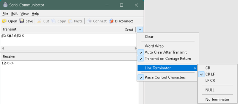

    I just got one step further.
    The manual says that the control character must be sent three times in a raw. Well, so I did wrongly: #26 + enter, #26 + enter and #26 + enter.
    But this is how I just finally made it: #26#26#26+enter.
    The module's response at "logger" mode launch is "12<". Toggeling to "command" mode adds "~>".
    Took me a few hours of searching but finally got there
    ...might help someone else....

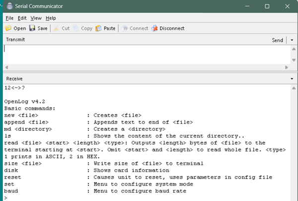

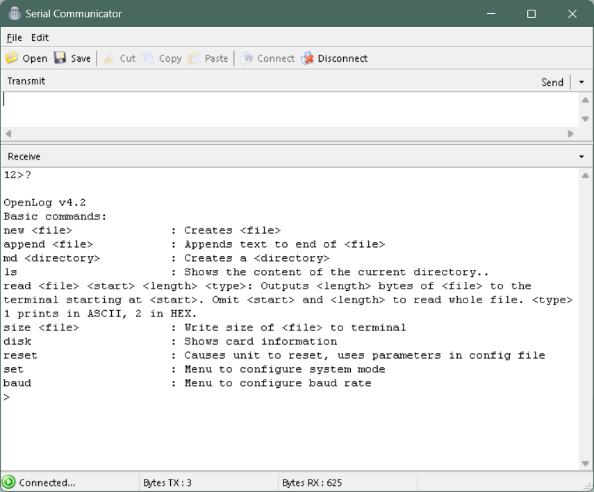

    SWITZERLAND (french speaking)
    952
    Default Openlog MicroSD data logger module
    Yes, I was already able to communicate with the module before by modifying the "config.txt" file on the SD card.
