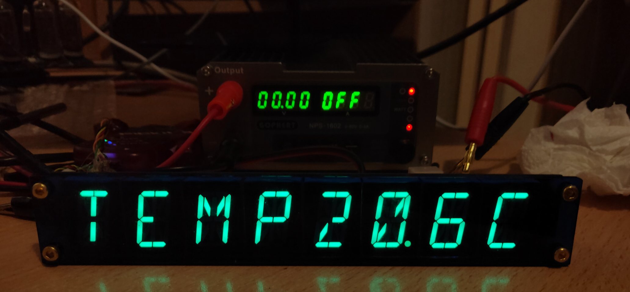

    Decoder routine and other code works fine. I'll check other things too later. I already tried setting mode 6, no difference.
    The USB<>Serial converter is common one, based on CH340 chip.
