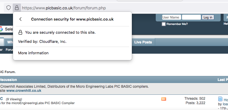

  34. #114
    Apr 2003
    Cambridge - UK
    1,057
    Default Re: to many redirects
    Name:  Screen Shot 2023-02-15 at 17.59.42.png
    If you exit the picbasic.co.uk page and clear your browser cache, Cookies and all site data. Close your browser. Re-Open and vist the site, you should see that the site is secure and running a certificate from a trusted CA ( cloudflare). The whole site is running behind cloudflare.
    Lester - Forum Administrator
    www.crownhill.co.uk
  35. #115
    Apr 2003
    Cambridge - UK
    1,057
    Name:  Screen Shot 2023-02-15 at 18.07.40.png
    Just checking I can upload imges without problems.
    Seems OK
    Oh and this is how the server is secured.
    We are secure to Cloudflare and Cloudflare secures to the end users browser.
    www.crownhill.co.uk
