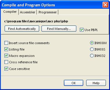

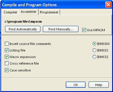

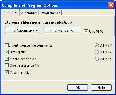

    I've tested with the Pic, but without luck, nothing happens...
    Are this configurations correct?
    Nuno

    Default Re: 18F2550 and Blink Led
    The default location for PBP is
    c:\pbp
    But if it is compiling where it is...
    How did PBP get installed inside of MCS?
