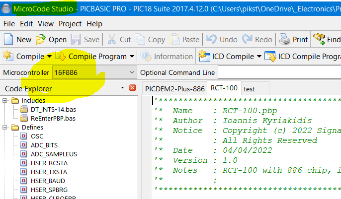

    Why don't you use the free MCS IDE?

    Which device the compiler builds the code for is specified using the -p option passed to the compiler exectuable. There is, as far as I know, no way to specify that in the source code itself. See section 8.3 in the manual.
    If you use MicroCodeStudio it will handle this for you, generating the correct command line parameters based on the selected device and other options.
    Tip: define osc 8 won't work, osc needs to be in upper case:
    define OSC 8

    And still there is no way to direct the use of specific PIC in the #config block.
    Use the MCS IDE that came with your purchase of PBP. Is the easiest solution.
