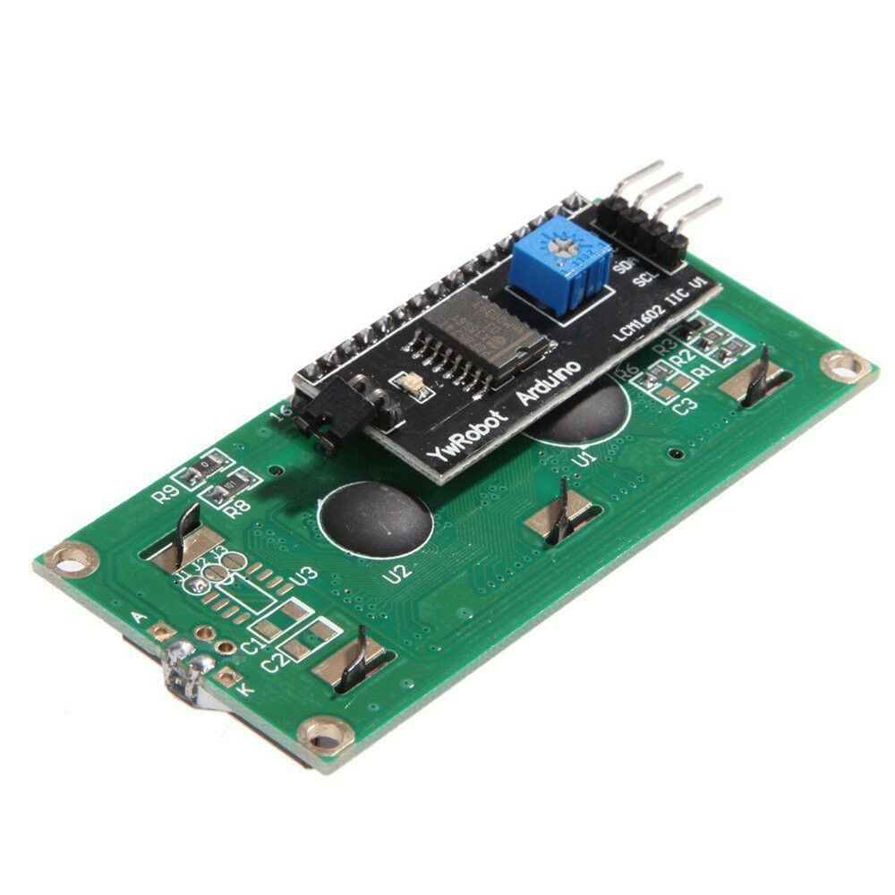

    Picture is adapter used. (Ebay) LCDs with adapter attached can be ones that the address is fixed.
    As it came it was 0x27 Dec 39 but I had to double it for pbp to 0x4e dec 78.

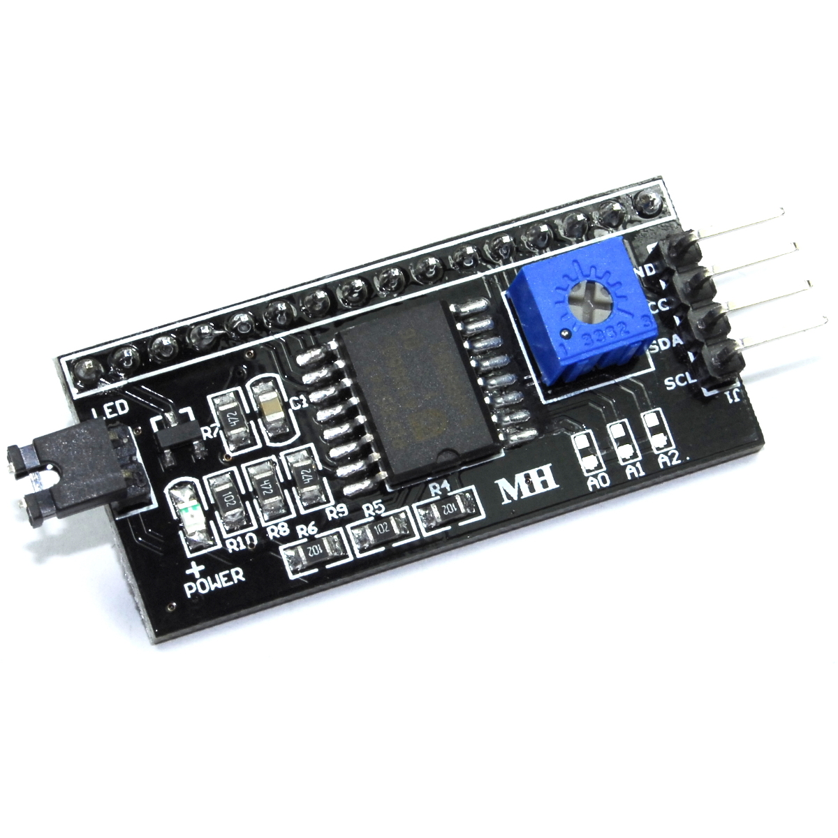

    Just becareful with lcds that have backpacks already attached, some do not have the SDA SCL pullups on board, hence may not work. I hooked up a lcd with backpack fitted and it would not work until 10Ks were added.
    Picture below is the backpack to avoid, apart from the fact you cannot change the address even if you wanted.

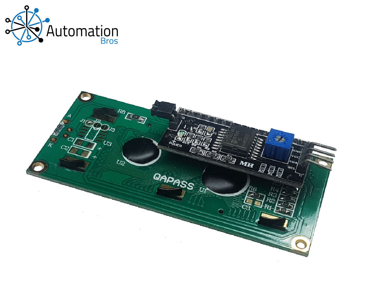

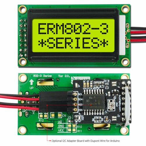

    My hardware looks more like this:

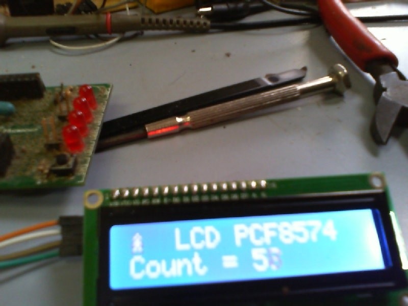

    bought one
    verified address a0 a1 a2 not grounded therefore $4e
    verified lcd data pins on PCF8574 high nibble therefore LCD_PCF8574a.pbp
    adjusted Test_LCD_PCF8574.pbp to siut
    ;----[Setup LCD using PCF8574 Port Expander]------------------------------------
    LCD_Addr CON $4e ; A0, A1, A2 tied to ground
    INCLUDE "LCD_PCF8574a.pbp" ; Include LCD module for PCF8574
    Backlight = 1 ; Turn on LCD Backlight
    worked first go
    what more could you want
