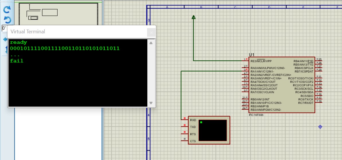

    2,714
    Default Re: Data processing in array
    result of sim
    Name:  Screenshot 2022-06-04 110905.jpg
