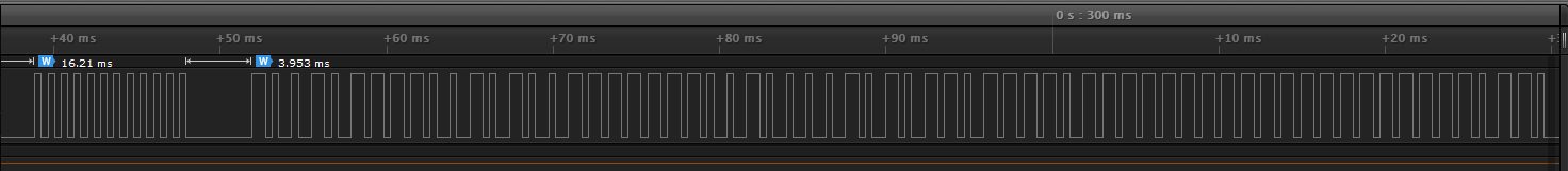

    I am trying to capture in an array the pulse width of a pulse train coming out of an HCS-301 chip.
    The pulses are not always the same in a raw but the width should be fairly consistent as the Logic analyzer confirms, about 800μsec and 400μsec.
    The PIC is the F886 at 8MHz so the resolution of PulsIn is 5μsec. Based on this the attached Excel shows some readings and though some pulses are in the correct range others are even 0 despite the use of PulsIn with a positive pulse trigger.
    Cannot understand why this happens.
    The complete pulse train consist of a guard width of 16ms, then 12 pulses of 50% 400/400μsec, a second guard width of about 4ms and then 66 pulses of 800 or 400μsec.
