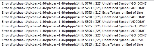

    Hello to the Community.
    I am using PBP Compiler version 2.46
    I started by programming BasicStamp 2SX and then adapting the programs to fit into PiCs.
    I switched to Picaxe (also programmable in Basic) and am now trying to adapt my Picaxe program to fit into a Pic12F629.
    However, the compiler gives me errors that I don't understand
    For example, it mentions undefined symbol names that do not exist in the program: GO_DONE, ADRESH, ...
    What are these "extra tokens", ...?
    Can you help me?
    In appendix, print screen of the compiler errors and... the code.
    Thanks.

    Compiler ERRORS:
    Name:  Compiler Errors.jpg

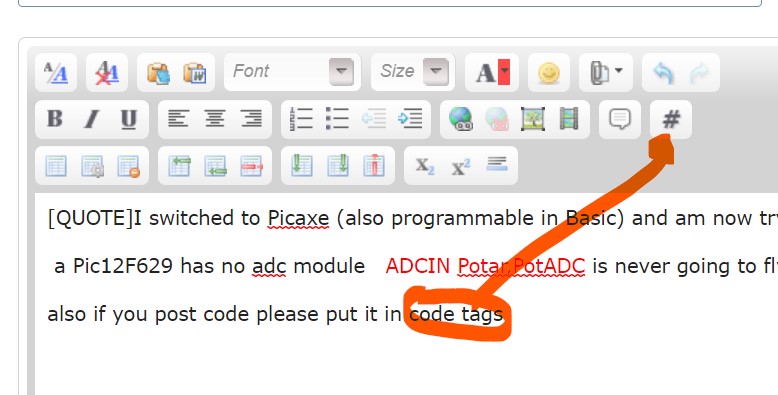

    a Pic12F629 has no adc module ADCIN Potar,PotADC is never going to fly use a Pic12F675
    also if you post code please put it in code tags Name:  Screenshot 2022-05-10 082543.jpg

    Hi Richard,
    Thank you for your quick reply !
    I had indeed noticed this small difference between a 12F629 and a 675 and that's why I have these two components in stock!
    Inattention error !
    It's getting late !
    OK, the compiler doesn't give any more errors.
    For the code tags, I had searched in the multitude of icons, without success.
    I'll keep this in mind for the next few times.

    In the case of my present application, it was a stupid error of inattention because, indeed, the Pic12F629 does not have an ADC contrary to the 12F675!
    This indeed caused incomprehensible compiler errors.
