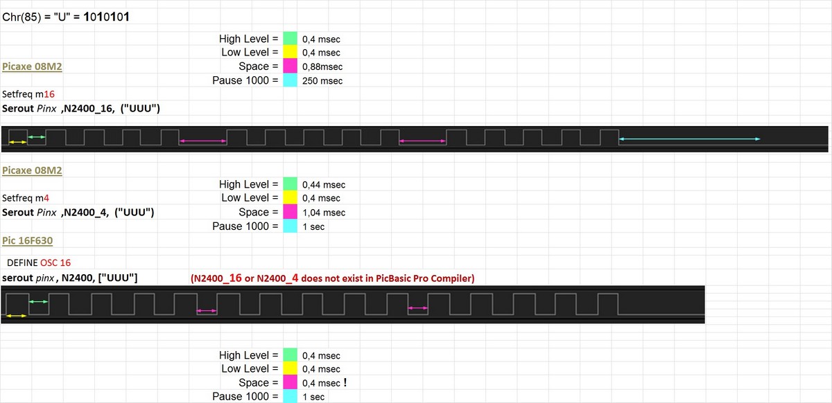

    Hi Richard,No, no reason, I thought!
    But the reality seems unfortunately different.
    To use the serial display driven by a (Basic)Picaxe; the picaxe command is Serout, pinx, N2400_4 or N2400_16 depending on the picaxe used.
    But, with PBC, the command Serout, pinx, N2400 does not give the same chronogram !?
    See attached image.
    I try to use this display (AXE 134), or find another model compatible with my PIC.
    ThanksName:  _SEROUT.jpg

    Bit timing seems to be in the ballpark for 2400 but apparently the PICAxe has quite a bit of delay between each byte (usually not what you want to see). If the display(s) do work with the PICAxe and the timings you show are correct then you can force PBP to insert extra delay between each byte it sends by inserting the following line.
    DEFINE CHAR_PACING 500
    This will insert 500us delay between bytes (when using SEROUT) which should then match the PICAxe timing.
    If you switch to SEROUT2 then the above DEFINE doesn't work so check the manual if that's something you're planning to do.
    I'm not into PICAxe but if I'd guess the _4 and _16 tacked onto the end of the SEROUT command simply specifies which routine to call based on if you're running at 4MHz or at 16MHz. In PBP you use DEFINE OSC 16 and the compiler automatically handles the timing for SEROUT (and other stuff).

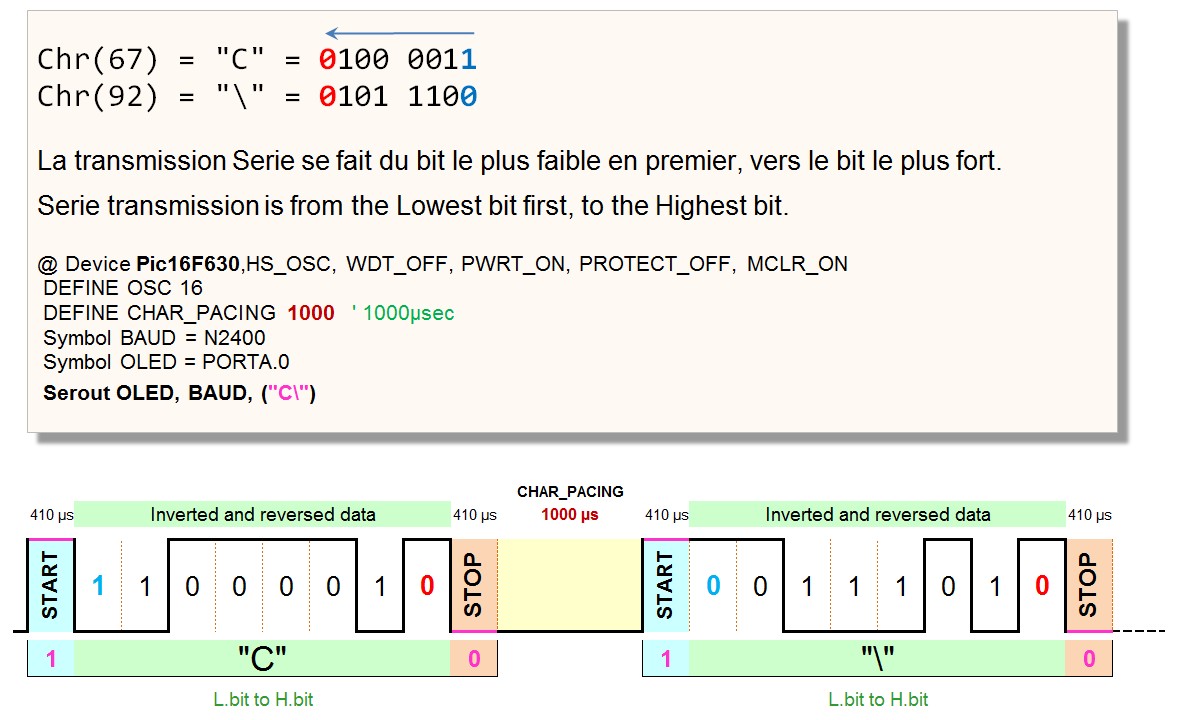

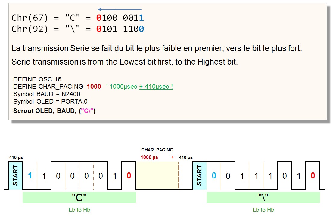

    @Henrick
    I have drawn the timeline in the case of a transmission of two spaced bytes with the command DEFINE CHAR_PACING 1000.
    I can see, however, that in addition to the normal Start bit of 410µs, another delay of 410 µs is added to the Pacing 1000!?

    No, you're forgetting the stop-bit! You have 1 startbit, 8 databits and 1 stopbit.
    In your diagram, from left to right: First you have the start-bit (1), then you have 8 data-bits (11000010), then you have the stop-bit (0) and THEN you have the 1000us CHAR_PACING before the next start-bit.
