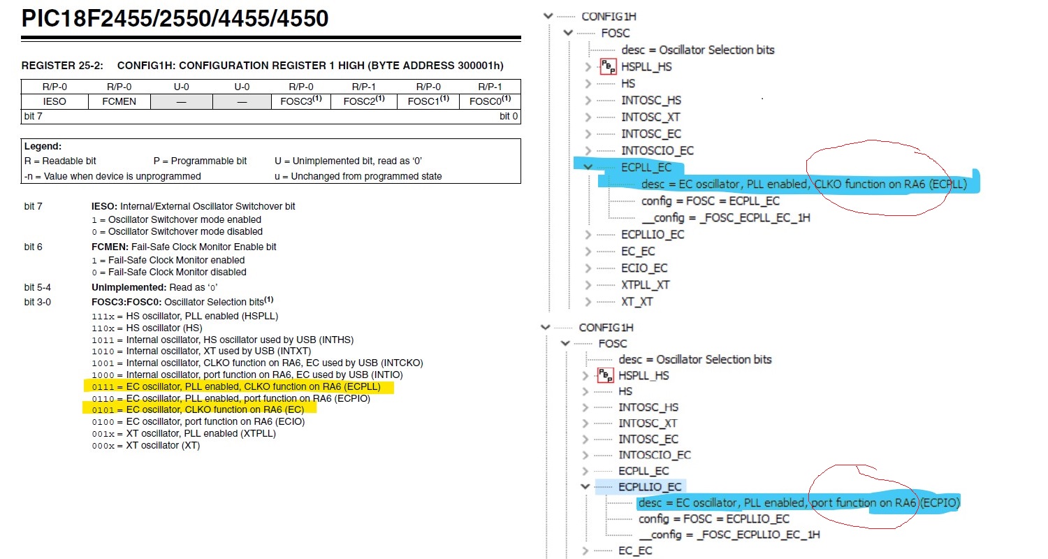

    4,177
    Default Re: 18F4550 Config settings
    This is the configuration that is making my life miserable...
    Cannot understand why on earth it does not work...
    Once it started at a very very low speed and that was it. Dead still since.
