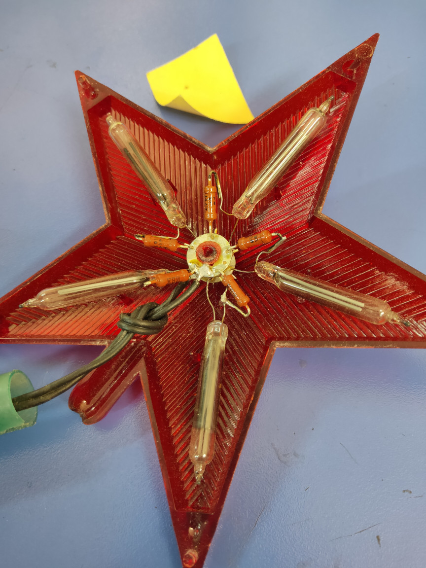

    Thanks! will give it a try - currently have no monitoring capabilities connected to the PIC. Only way to interact is to write data to EEPROM and check the value via pickit 3 standalone programmer. Will try to add write routine to your code...
    This circuit will be used to upgrade old Christmas tree decoration, shaped like a red star
