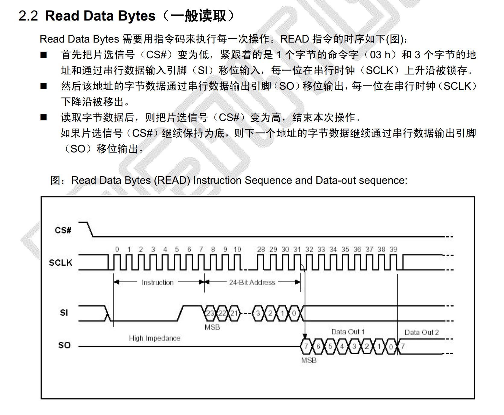

    I'm trying to connect GT21L16S2Y Font ROM IC to PIC16F886.
    I have soldered connections, but have not written code yet, because this chip has separate IN/OUT pins for SPI.
    Below is the draft code which I think should work (have not tried it yet).

    And here is screenshot from the datasheet. It is in chinese, but diagrams show things clearly.
    So I'm on the proper way or not?

    Default Re: 4 Wire SPI with Shiftin/Shiftout ?
    Of course they have separate in/out pins, that's how SPI works.
    I think so. But for starters, looking at the image you posted you should send an 8 bit command followed by a 24 bit address (32bits in total), you're only sending 16.
    not. the shiftout shiftin commands leave the clock line high on completion{mode 5} so when you swap between them the slave device will see
    a false rising edge and you lose a data bit .
    nearly all respectable pic16/18 chips have a mssp module why not just use it ?
    or write a bit banger to suit
