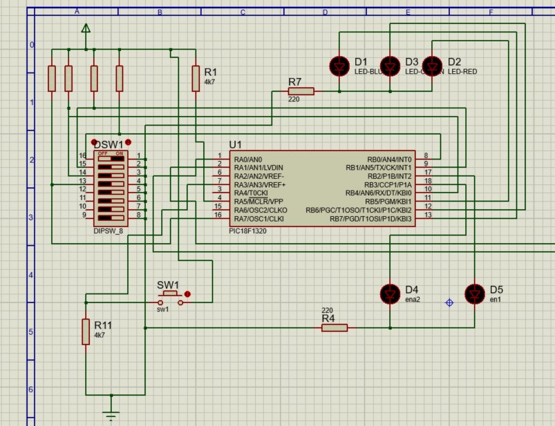

    Here's the entire code.
    Redport = 0 was a typo and should have been = 1. The loop worked once I disabled the external oscillator requirements for timer1.
    18F1320 using internal 8MHz oscillator (because I have hundreds of them from a past project! :-) )
    So this code is almost there functionally but has a couple of problems.
    The project is to run some high power LED's for either 60, 90, 120 seconds. There is a lid that has to be closed (SSW=1) before it will allow the LED's to be turned on. If the lid is open, it will just sit there and flash redport until the lid is closed. At this point with lid closed, the redport indicator led will be on solid and it'll move into main1.
    The main LED's get turned on with a momentary push button switch by the user. The timer should start, count up until Runtime is reached, switch off the LED's (enable1 and enable2 = 0) turn on greenport which is a green "done" indicator LED, and it should sit there until the lid is opened again.
    On lid open it should return to the first loop and flash redport until the lid is closed again. While the timer is counting and the main LED's are on it has to monitor for the lid being opened and shut off the main LED's and return to the first loop with the counter ready to start at Runtime.
    So that said here is what works:
    It sets up correctly, will load either 60, 90 or 120 in to Runtime, will sit and flash redport with the lid open.
    It will go in to main1 with a solid redport and wait for the pushbutton input (Startswitch)
    It will turn on the timer, count and when done will turn off the main LED's and turn on greenport and sit there until the lid is lifted (SSW=1)
    What isn't working is:
    Its not counting to the correct number in Runtime. I use greenport in the timer loop to basically have a pulse to look at on the scope showing that the timer is indeed running, and it is. The pulses are approx 1ms apart but they are only running 50% of the time. So say 100 pulses 1ms apart (I haven't counted the actual number yet) then nothing for 100ms then 100 pulses 1ms apart etc etc.
    Currently it runs for about 630ms if Runtime = 60, about 900ms if Runtime = 90 and never turns off if Runtime = 120. I added the thousandths to see if I could increase the on time and it doesn't respond, staying on all the time. When the lid is lifted it does interesting things and gives a wonderful flashing combination of the red green and blue indicator LED's. Clearly I'm setting up the timer wrong but I'm not sure what I'm doing wrong at this point and could use some fresh eyes.

    OSCCON = %01110011
    DEFINE OSC 8
    DEFINE WRITE_INT 1
    Include "modedefs.bas"
    SSW var PortA.7
    redport var PortB.5
    blueport var PortB.7
    greenport var PortB.6
    enable1 var PortB.2
    enable2 var PortB.3
    runtime var word
    RunningFlag var BIT
    Startswitch var PortA.3
    ended var bit
    Thousandths var word
    Hundredths var word
    Seconds var word
    comp var bit
    adcon0.0 = 0
    adcon1.3 = 1
    adcon1.4 = 1
    adcon1.5 = 1
    adcon1.6 = 1
    TRISA = %11111000
    TRISB = %00010011
    PortB.5 = 0
    PortB.2 = 0
    T1CON = %00000100
    comp = 0
    redport = 0
    greenport = 0
    blueport = 0
    enable1 = 0
    enable2 = 0
    ended = 0
    runningflag = 0
    thousandths = 0
    Hundredths = 0
    Seconds = 0
    Gosub SetTimer
    blueport = 1 'testing outputs
    pause 2000
    blueport = 0
    greenport = 1
    pause 2000
    greenport = 0
    On Interrupt goto Starttimer
    PIE1.0=1 ' Enable TMR1 Interrupts
    INTCON.6=1 ' Enable all unmasked Interrupts
    INTCON.7=1 ' Enable Global Interrupts
    if PortB.0 = 0 then
    if PortB.1 = 1 then
    if PortB.4 = 1 then
    runtime = 60
    if PortB.0 = 1 then
    if PortB.1 = 1 then
    if PortB.4 = 1 then
    runtime = 90
    if PortB.0 = 1 then
    if PortB.1 = 0 then
    if PortB.4 = 0 then
    runtime = 120
    write 5, runtime
    if SSW = 1 then
    redport = 1
    pause 200
    redport = 0
    pause 200
    if SSW = 0 then
    redport = 1
    goto main1
    'main code loop
    Enable
    main1:
    if ssw = 1 then 'checks to see if lid is closed, if not,
    goto main 'go back to first loop and wait
    endif 'if lid is closed, continue on to next requirement
    if SSW = 0 and startswitch = 1 then 'starts the first run of the timer if lid
    ended = 0 'is closed and push button has been pressed
    runningflag = 1 'and sets a flag to show timer is running
    GOSUB StartTimer
    if runningflag = 1 then 'checks to see if timer was started and
    gosub starttimer 'if true loops for next cycle
    goto main1
    disable
    completed:
    T1CON.0=0
    enable1 = 0
    enable2 = 0
    greenport = 1
    redport = 0
    blueport = 0
    runningflag = 0
    comp = 1
    if ssw = 1 then
    greenport = 0
    goto completed
    ' Subroutine Loads TMR1 values
    SetTimer:
    T1CON.0=0 ' Stop the Clock
    TMR1H=$B1
    TMR1L=$e7
    PIR1.0=0 ' Reset TMR1's Interupt Flag
    ' Subroutine to stop the timer, reset, and shutoff outputs
    Stoptimer:
    T1CON.0=0
    TMR1H=$B1
    TMR1L=$E7
    PIR1.0=0
    enable1 = 0
    enable2 = 0
    thousandths = 0
    Hundredths = 0
    Seconds = 0
    redport = 0
    blueport = 0
    greenport = 1
    runningflag = 0
    ended = 1
    'gosub settimer
    Pause 1000
    Starttimer:
    redport = 1 'output to show timer is running
    blueport = 1
    greenport = 0 'provides a pulse to measure for diagnostics to check timer is actually running
    greenport= 1
    greenport = 0
    enable1 = 1 'turns on both LED channels
    enable2 = 1
    Gosub SetTimer ' Set the Timer for next Interrupt
    If RunningFlag=1 then ' If timing actually enabled then continue
    thousandths=thousandths+1
    if thousandths>999 then
    thousandths=0
    Hundredths=Hundredths+1
    If Hundredths>99 then
    Hundredths=0
    Seconds=Seconds+1
    write 10, seconds 'just to see if it turns off at runtime seconds
    ' Increment the Seconds
    if seconds = runtime then
    gosub stoptimer
    goto completed
    if ssw = 1 then
    gosub stoptimer
    Resume

    my view of schematic
    Name:  Screenshot 2021-09-28 194517.jpg

    Wow Richard, thanks for that! I guess I was way off. I used Melanie's Olympic Timer as the basis for my code and she included some of the things that you have advised against such as adding the SetTimer subroutine call in the Starttimer routine and INTCON.7=1.
    I tried your code and needed to change a few things.
    OSCCON = 110011
    TRISA = 111000
    TRISB = 010011
    became
    OSCCON = %01110011
    TRISA = %11111000
    TRISB = %00010011
    in order to compile.
    If you open the lid while its running and close it again, then push the start button, it doesn't turn on the outputs and start timing again. It does jump back to main, it will jump in to main1 and put the red led on solid, but doesn't run main1.
    If the switch is in the 60 second run position it runs for about 10 seconds - which I saw you had runtime = 10 so I changed that.
    In the 90 second position it runs for 90 seconds - perfect.
    In the 120 second position it ends almost instantly. I noticed this would happen sometimes in my code too. 100 and less and it works each time. I don't know what this phenomena is.

    we are still in a covid lockdown [no 5 i think ] hence i'm bored shitless and will do anything that takes my interest
    yes the forum has the ability to eat % symbols
    60 seconds is too long to wait while testing
    not on the simulator , works ok at all settings
    if you want to be able to run code repeatedly then seconds and comp need to be reset to zero before a rerun
    like this

    2,666
    Default Re: Loop issues
    a state machine approach simplifies the logic enormously , has a much more predictable result
    and is vastly simpler to debug

    2,666
    new cleaned up version with comments
    just to emphasize the versality of state machine approach
    debounce of start button added
    validation of runtime selection added
