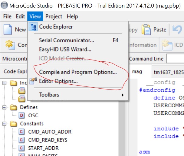

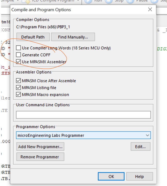

    the assembler gets a bit picky about old stuff like dt ints these days if coff generation is enabled.
    coff is now pretty much useless for pbp since it is no longer supported in mplabx for source level debugging

    I'm using old stuff I don't see an option to enable or disable generation of COFF files in this super old version of MCS+. 3.0.0.1 I think, MPLAB is 8.20a, mpasm is 5.30, and pbp is 2.60a.

    Default Re: DT-ints and elapsed timer compilation errors.
    Name:  Screenshot 2021-09-17 143507.jpg
    if its not there then u need an upgrade
