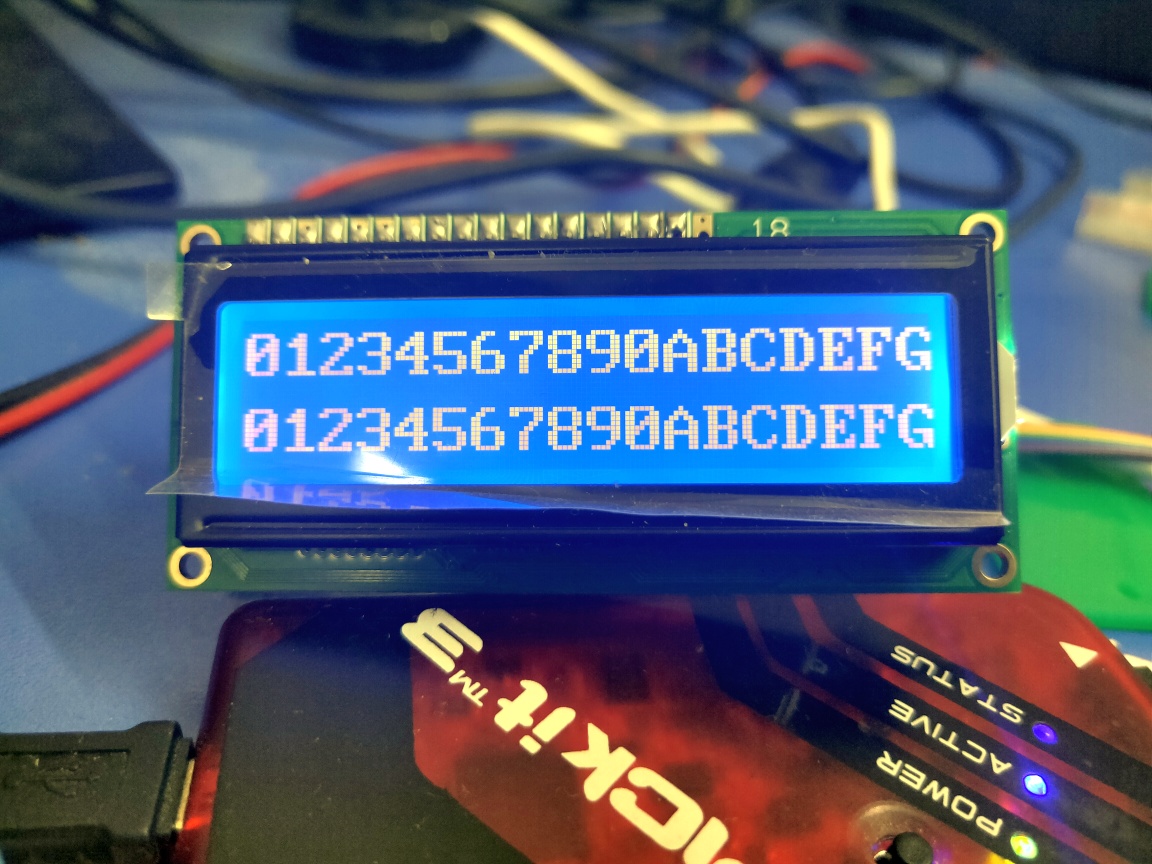

    I also got this module, soldered jumper for parallel connection and it works with PBP LCDOUT more or less. But there are some issues - most LCDOUT commands are not supported. Like moving cursor to 2nd line and so on. By guesswork, I've determined that, instead of
    LCDOUT $FE, $C0
    You should use LCDOUT $FE, 208
    to get cursor at beginning of 2nd line.
    Also, LCDOUT $FE, 27 or something, switches it to graphical mode.
    But I'd like to use it's ability to have custom fonts and so on.
    Anyone dug deeper?
