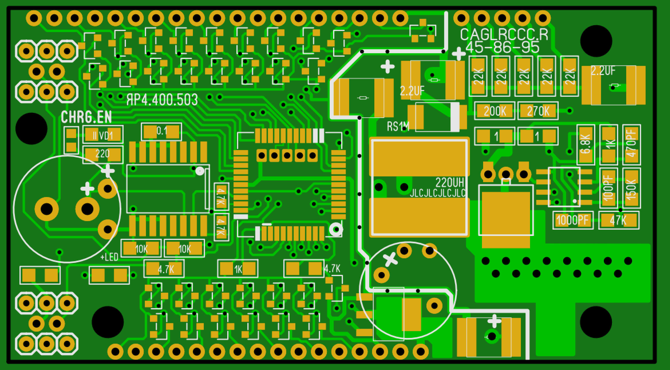

    here is PCB

    pointless snippet . how is adc setup ?
    good luck trying to use adc value without passing it through a lpf
    a pic of blank pcb is not a schematic

    Unfortunately, I don't create schematics - I directly draw PCB, since I can read it in same way, as schematics
    that just explains so much

    That PCB is quite large - about 88x44mm, now I've designed even more compact one, just 70x30mm. Good I haven't put it into production yet - will add capacitor place to PCB.
    Actually, reading schematics via PCB is not that hard - just you need to learn it, as you do with normal schematics.

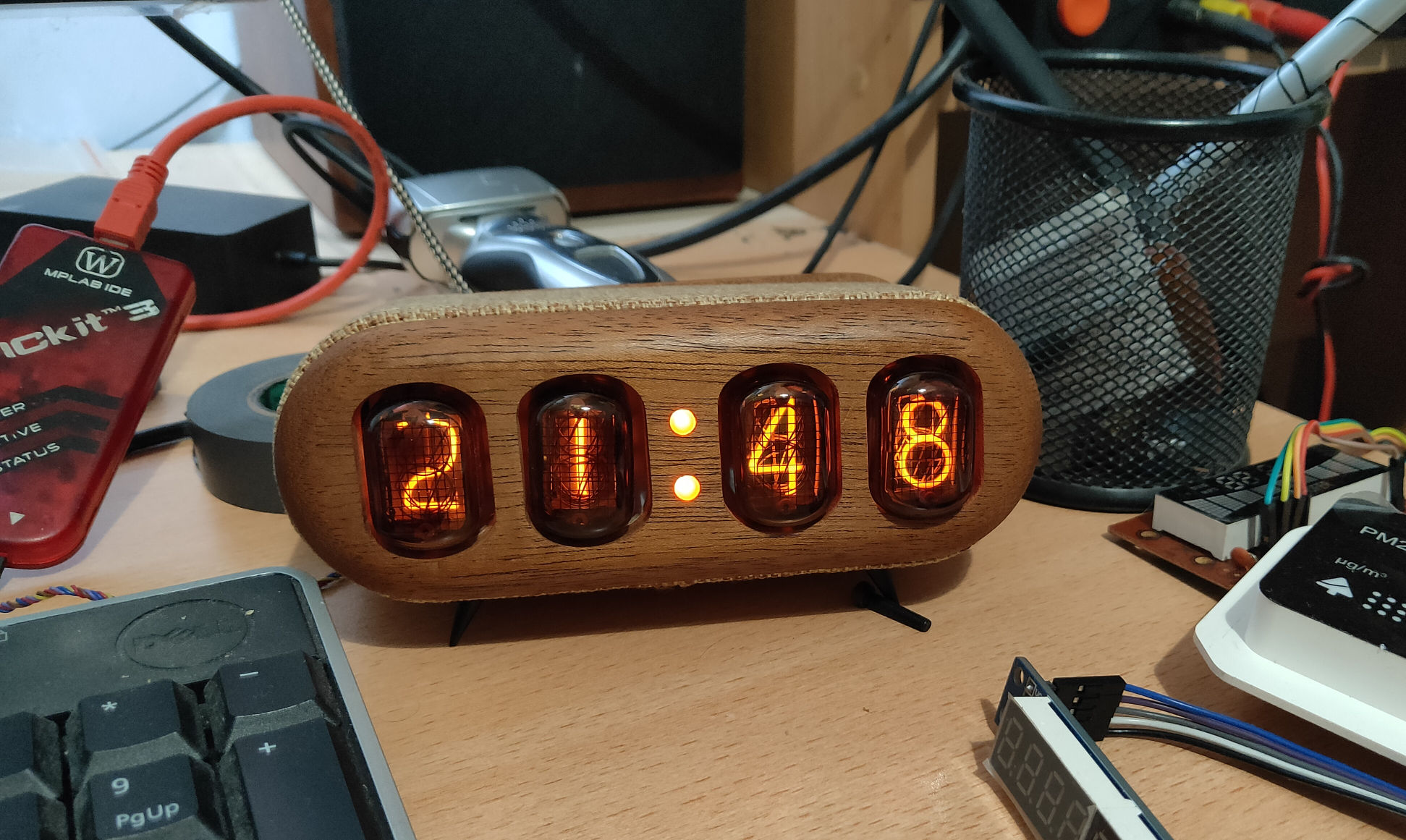

    And by the way, there was another issue which I've fixed now, and quite likely it was also causing the problems
    Due to coding error, I had that brightness adjusting PWM routine called 500 times per second (it was placed in middle dot blink loop)
    and when you use HPWM statement, instead of changing the current PWM register, Picbasic stops the pwm generator and restarts it with new values (you can check this with oscilloscope) which causes additional noise generation. Now I moved it into segment refresh routine, which happens once per minute (and keyboard input is deactivated during it), so most likely, it should work without capacitor now, but too lazy to take it apart and unsolder
