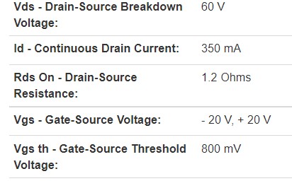

    As an aside. Has anyone used a 2N7000 Mosfet attached to a 3.3v pic output to drive a relay?
    what relay ? specs ?
    2N7000 specs are admirably suitable for low voltage / low coil current relays
    an IRLZ44N to drive a smallish relay is way overkill
  8. #48
    Default Re: Active low transmitter question
    I agree Richard. It's like putting a Ferrari engine on a lawnmower. At work we have a small PCB with an 8-pin PIC and 4 of these mosfets. It replaces about a dozen different subassemblies in products all governed by the PIC program. These transistors sometimes simply switch a string of LED's on and off, a 2A DC motor or a combination of the two. That's why I am "programmed" to using them.
