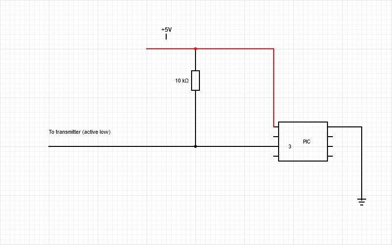

    Name:  Transmitter Active Low Switched from PIC.JPG
    Can someone kindly help please?
    I have a RF Transmitter that transmits active low but to avoid 'floating voltages' (that could trigger a not wanted transmission) I was thinking the above cct might prevent this happening.
    My thinking is the 10k resistor would hold the Transmitter input and pin3 on the Pic high until my code would make pin3 go low for a few milliseconds and make the Transmitter transmit, am I in the right ballpark with my thinking?
    As ever all help very much appreciated.

    I suppose it boils down to how much "oomph" the transmitter packs. If it's a weak signal, it may not be able to overcome the 10k pull-up. If it has sufficient amp capability, then you're golden. The best answer will be given from your test. It either works or it doesn't. As posted, not enough information to go on.

    If your question is, "Can the PIC safely overcome the 10k pull-up resistor?", the answer is absolutely yes. Again, will it do what you want, you'll just have to try it and see.

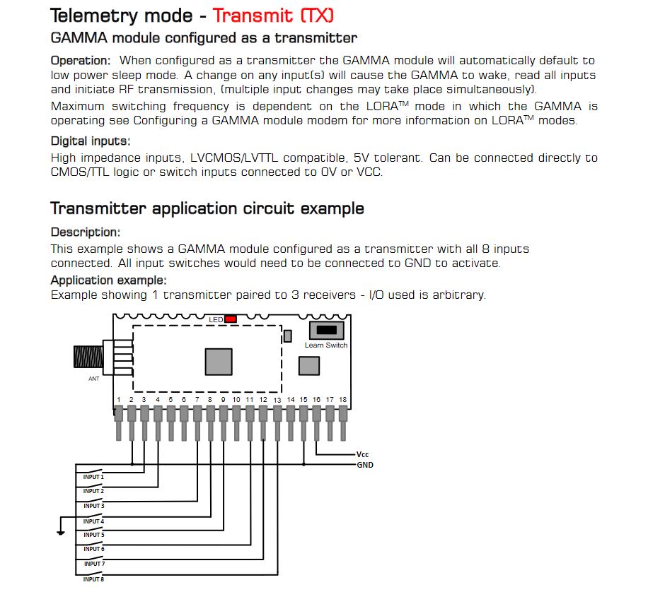

    2,719
    Default Re: Active low transmitter question
    I intend to use maybe a 12F683 to pull a Transmitter Input pin LOW for a few m/s to make it transmit then hold the Tx pin high to stop false triggering via floating voltages if this is safe to do this without damaging the transmitter or pic
    what is your doubt ?
    the data so far indicates no need for pullups , the schematic shows none.
    a pic pin when configured as output will never "float" its either high or low when set

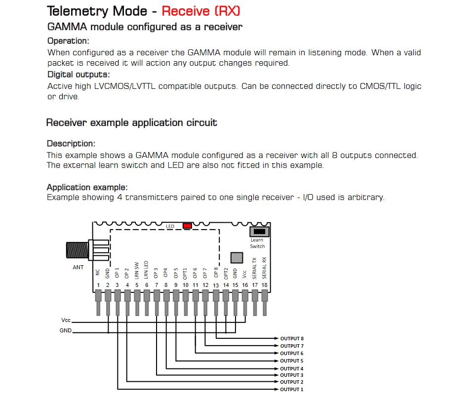

    Here's the Rx schematic. When an Rx is received it outputs 5v onto the corresponding pin, which will then be read by the pic.
    My question now is (and this should have been the question all along):
    On the 12F683 pic I need to set a Tris pin to INPUT and read the pin for state change from LOW to High as the Rx is received.
    TRISIO = %00000001 'Set to Input
    TestRx 'LABEL
    Do SomeThing 'LABEL
    TestRx
    IF
    GPIO.0 = 0 THEN TestRx 'Nothing has happened continue to loop and check for state change
    IF
    GPIO.0 = 1 then DoSomeThing
    DoSomeThing
    Set alarm off in this case........
    So, here's the $64k question from me: How do I hold GPIO.0 LOW until a 5v Rx is received? Is it a pulldown resistor?
    2,719
    posting pictures of text is really annoying , post the actual data sheet or a link.
    the annoying picture that cannot be seen when replying says that the output pins are set to reflect the incoming pkt data
    why would the pins change between pkts ?
    how can the pic even know when new data has arrived ?
    how do u know when data is valid ?
    there is no mention of pullups or pull downs in schematic
    a pull down here would be nothing but detrimental in my view

    Telemetry mode - Transmit (TX)
    GAMMA module configured as a transmitter
    Operation: When configured as a transmitter the GAMMA module will automatically default to
    low power sleep mode. A change on any input(s) will cause the GAMMA to wake, read all inputs
    and initiate RF transmission, (multiple input changes may take place simultaneously).
    data sheet

    'the state will remain high till Vin is less than or equal vil where its guaranteed to go low'
    So switching Vin LOW (from pic) causes a Tx?
    And
    Transmitter will continue to Tx until Vin goes High?
    4,175
    No. Only when there is a state change. We said that. Transmission happens on change once and only.
    But you shouldn’t care at all. You should care only for your logic state. And maybe your voltage levels not to fry your module.
    'No. Only when there is a state change. We said that.'
    Yes you did Ioannis, I'm just trying to understand the mechanism here.
    'You should care only for your logic state. And maybe your voltage levels not to fry your module.'
    The data sheet does say [High impedance inputs, LVCMOS/LVTTL compatible, 5V tolerant] would you say I could leave 5v on the Input pin to transmitter and switch to 0v/ground to cause a Tx safely? There are two module versions below, should I go for number 2 to be safe? Or is there a low voltage 12f683 that you know of, or is 5v fine?
    1/ Part Numbering 2.4 -3.6V Version
    2/Part Numbering 3.6 -15V Version
    2,719
    what you have is a lora long distance two way packet radio system that transmits the entire device state each time any input pin changes
    to paired receiver constrained by the tx transmission time, that time is between 55 and 1002 mS depending on mode.
    Also you can feed just 3.3 power supply to most pics. They work just fine.
    Thanks for that Ioannis - I think 3.3v is the best option here.
    I would love given time to learn how to send data with the LoRa module and pic but that's for the future and a lot more learning my end (end of Summer/Autumn/Winter project).
    What I am after here, is to use the Tx/Rx as a switch at about 350m range so question:
    Am I right in assuming that (once paired) a state change on say Input pin1 on the Tx would be reflected as Output on pin1 on the receiver (acting as a simple switch in effect) or is that far to simple?
    its not some cheap OOK thing

    Hi Ioannis - I came across this short instructional / demo video for anyone else who's interested in this topic, simple video but shows Tx/Rx in action. It's not the exact same model as the ones I've now ordered but very similar, you may have to scroll down the page a tad to see the video.
    http://www.rfsolutions.co.uk/radio-m...ule-1000m-p378
    Feb 2010
    I live in the UK
    562
    Sorry guys another question from me.
    The demo video shows a lady pressing a push button to ground on Tx Input pin1, which on the Rx latches an led on, so:
    How do I mimic a 'single' button press to ground on Tx Input pin1 from a pic? do I:
    Just set GPIO.0 = 0 'Pulls Tx pin1 LOW causes a Tx
    then set GPIO.0 = 1 'pulls Tx pin1 High, from data sheet Tx Inputs pins are internally pulled high anyway
    Or would the above cause two Tx's
    Or do I:
    Set GPIO.0 = 0 'Pulls Tx pin1 LOW causes a Tx
    Then Change TRISIO = %00000001 'Set bit.0 to input and mimic a floating open switch Tx Inputs pins are internally pulled high
    2,719
    yes on a different device to what was previously discussed and not to mention the woefully inadequate description of the hardware
    is the switch momentary or latching ?
    if the switch is momentary then the operational description in the data sheet completely fails to explain the toggle action
    occurring
    consult the salesman
    Feb 2010
    I live in the UK
    562
    Ok, ignoring the video and the different device and back onto this one.
    How do I mimic a 'single momentary' button press to ground on Transmitter Input pin1 using a pic instead of a button? do I:
    Set TRISIO = %11111110 'set bit 0 to output
    Then set GPIO.0 = 0 'Pulls Tx pin1 LOW causes a Tx
    Pause 50ms 'Alow time for Tx
    Then set GPIO.0 = 1 'pulls Tx pin1 High, from data sheet Tx Input pins are internally pulled high anyway
    Or would the above cause two Tx's (two state changes).
    Or do I:
    pause 50ms 'Alow time for Tx
    Then Change TRISIO = %00000001 'Set bit.0 to input and mimic a floating open switch, Tx Input pins are internally pulled high (data sheet)
    And then when I want to Tx again set the TRIS bit 0 then GPIO.0 LOW etc.
