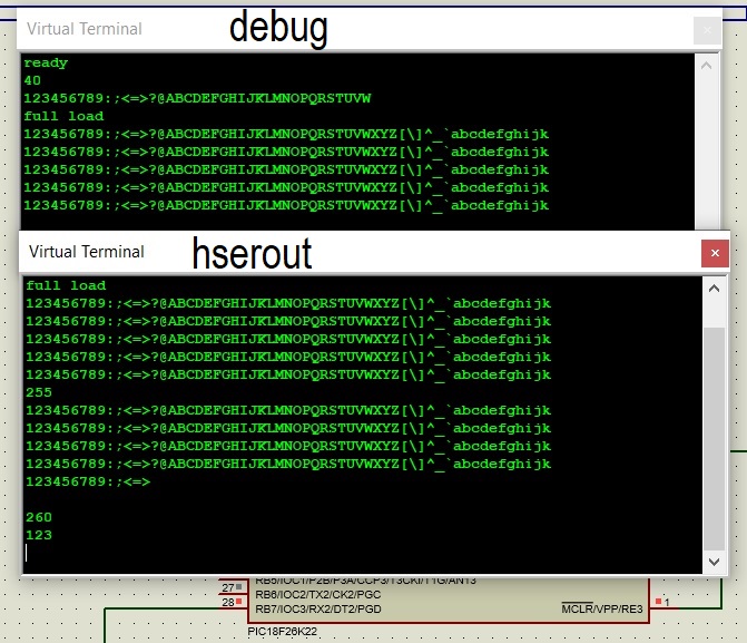

    Default Re: HSEROUT using STR modifier - length parameter as variable not working
    or even
    BalCount = 40HSEROUT [STR BalBuffer\BalCount,13,10]
    debug   STR BalBuffer\BalCount,13,10
    debug "full load",13,10
    debug   STR BalBuffer,13,10
    HSEROUT [STR BalBuffer,13,10]
    for   BalCount= 0 to 40
    next
    Unfortunately Charles Leo is not monitoring this forum. I 'll make a post on support.melabs.com to clarify this, since the manual is not very clear on the matter.
    I 'd rather be 100% sure that this is trusted all the time on all MCU's.
