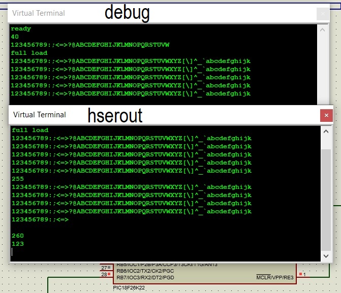

    it fails of course for more than 255 chrs
    BalBuffer VAR BYTE[300]
    BalCount VAR word
    latb.7=1
    clear
    for   BalCount= 0 to 59
    BalBuffer[BalCount]=BalCount+"0"
    next
    for   BalCount= 1 to 59
    BalBuffer[BalCount+60]=BalCount+"0"
    next
    BalBuffer[BalCount+120]=BalCount+"0"
    next
    BalBuffer[BalCount+180]=BalCount+"0"
    next
    BalBuffer[BalCount+240]=BalCount+"0"
    next
    BalBuffer[0]=13
    BalBuffer[60]=13
    BalBuffer[120]=13
    BalBuffer[180]=13
    BalBuffer[240]=13
    pause 2000
    debug "ready",13,10
    BalCount = 40
    HSEROUT ["40 ",STR BalBuffer\BalCount,13,10]
    debug   "40 ",STR BalBuffer\BalCount,13,10
    debug "full load "
    debug   STR BalBuffer,13,10
    HSEROUT ["full load ",STR BalBuffer,13,10]
    BalCount = 255
    HSEROUT ["255 ",STR BalBuffer\BalCount,13,10]
    HSEROUT [13,10]
    HSEROUT ["260"]
    BalCount = 260
    HSEROUT [STR BalBuffer\BalCount,13,10]
    3,624
    Default Re: HSEROUT using STR modifier - length parameter as variable not working
    Of course, since the macro only uses the low byte of R4 to index the array. That would also make it fail when using a constant >255.
    In any case, the "example" posted in the first place had a BYTE sized variable with a value of 40 and everything we've seen this far is that it should (and ideed does, for 18F at least) work. I think I compiled for 16F628 when I looked at the .lst yesterday.
