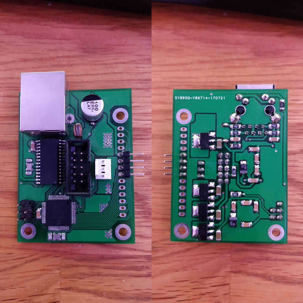

    For the hardware, I'm using a custom PCB with the PIC24EP512GP806, an ENC28J60 with an RJ45 socket and a bunch of headers.
    It's currently plugged into a breadboard which gives me 2 LEDs that I've been using to "debug" the code
    I've uploaded a picture of the board if you're interested
