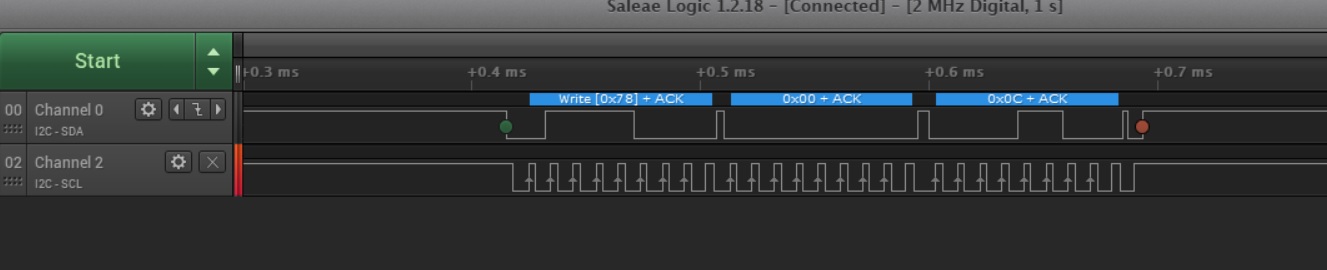

    this is how it looks on a logic analyzerName:  Untitled.jpg
    and this is a trace , is shows no signs of what you claim

    Interesting how my analyzer shows two READ transactions following each WRITE transaction - and your's apparently does not.
