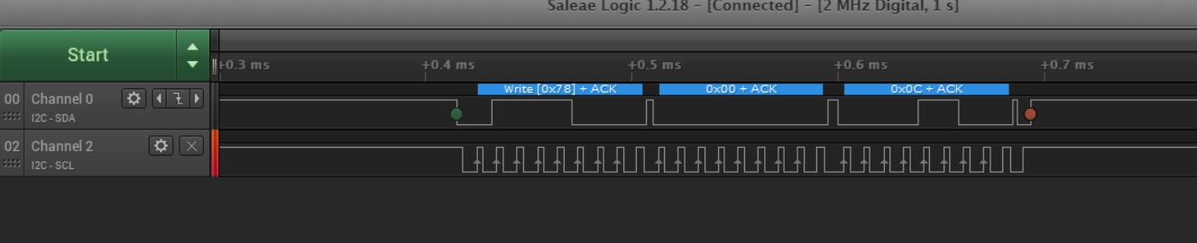

    Attached is also a screen shot of one of the I2C transactions.
    I was surprised to see two read transactions followed by one write transaction.
    Especially because there is no IC2READ occurring in the code.
    I'm simply writing one value to the IO chip.
    So I wonder if the chip is programmed to return the two READ transactions - or is PBP3 doing that as part of the IC2WRITE function?

    this is how it looks on a logic analyzerName:  Untitled.jpg
    and this is a trace , is shows no signs of what you claim

    Interesting how my analyzer shows two READ transactions following each WRITE transaction - and your's apparently does not.
    2,721
    Default Re: understanding I2CWrite optional address parameter?
    there is no apparently. its what should and does happen.
    more interesting is that your analyser does not even come close to reflecting what your "snippet" should reproduce.
    either your analyser is defective/miss used or the "snippet" is not what is being measured.
