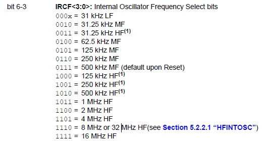

    Am I correct about the following also:
    16mhz internal clock: Set PLLEN off - and set IRCF = 1111
    8mhz internal clock: Set PLLEN off - and set IRCF = 1110
    2,729
    Default Re: 2nd Set of Eyes - with my Config settings for PIC16F1825 - running internal 32mhz
    the x4pll only works for intosc = 8mhz or suitable ext osc
    with no pll intosc from datasheet :-
