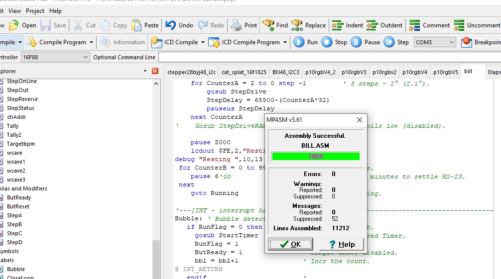

    I can't seem to compile without a huge list of errors (see attached) when exceeding the apparent
    2k boundary of a 16F88 (4k chip). I edited to use a 16F1847 with no difference.
    Can someone take a look at the error list and shed some light on what I may be doing wrong? I will send the code if it's needed.

    Hi Richard,
    Thanks for your help - "Generate COFF" is not checked. The strange thing is the code compiles and runs as designed to the 2k limit, but when I add extra text (either via debug or on the LCD) or anything else that pushes the code over 2070 words, it lists all those errors.
    My setup hasn't changed so I loaded an old 3k size program I wrote using the F88 and it compiles and runs fine. There is nothing flash about the problem code apart from using DT's Ints and a modified Inc file to run his Elapsed Timer code to 100ths precision, as I said, works well up to 2k only. I edited code and tried with Darrel's standard "Elapsed_INT.bas" and exactly the same result, compiles okay if less than 2071 words. PBP 3.0.10.4 and MPASM v5.71
    Any suggestions?

    Okay, here it is, note as is compiles but uncommenting the debug at line 318 pushes it over and it throws the errors.
    See attached also...

    2,644
    Default Re: Apparent 2k limit with 4k 16F88
    compiles just fine, its only 2059 words by my system
    Yes, the commented line above " for CounterB = 0 to 999 ' 1000 iterations."
    That's weird, I can't get past 2070 words.
    Feel free to add a bunch of anything to blow the code size out and see if it still compiles. I certainly can't - which begs the question what is different on your machine?
    Hi Richard,
    Thanks for the hint, yes changing my DT int's to v1.1 from 1.0 did the trick. Frustrating thing about it was I'd downloaded it a looonng time ago and didn't overwrite the old version at the time...
    It does show though the inadequacies of the error field - not a lot of help if you are not a guru.
    All the best for the New Year and do your best to stay away from New South Welshmen.
