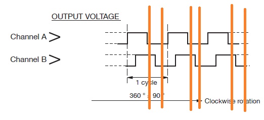

    Cool, thanks. Both pbp,asm version works. Anyway, I tried two encoder types which I had on hand. Both works, but one count two counts to one detent, and the second count four to one detent.
    I tried set the IOCBP and IOCBN to trigger only on positive edge or only on negative edge or different comination but it doesn't hepl.
    Any trick to adjust this to one detent one count?

    oneway to count detents divide the absolute raw cnt value by the number of edges/detent ,then restore the sign
    eg
    sb= cnt.15
    detents = abs(cnt)<<2; four edges
    if sb then detents= ~detents+1
    another is to just poll the rotation direction at an acceptable rate
    if clockwise add a count if anticlockwise subtract
    poll: ; call this sub say 5 times / sec or whatever
    if cnt>lastcnt then
    detent=detent+1
    elseif cnt<lastcnt
    detent=detent-1
    lastcnt=cnt
    another way is to only inc/dec detent counter only when enca and encb both = 1 (ie at detent pos)

    Hi Richard, sorry for later response. Thanks for pointing me in to right way how to do it. Your first method not works for me, the second method polling works just fine but slows down the response time. The third method inc/dec detent counter only when enca and encb both = 1 works but count every second detent and also slowes down the reading.
    My encoder has 30.position and give 15.pulses/rew. My solution is simply divide the CNT by 2.
    enc_isr:
    ev=ev<<2                ;shift last reading into position
    ev=ev|((portb&12)>>2)  ;read enc pins 2,3  mask off others then  combine this reading with last reading
    LOOKUP (ev&$f),[0,255, 1, 0, 1, 0, 0, 255, 255, 0, 0, 1, 0, 1, 255, 0],tmp ;lookup the decision matrix
    if tmp then             ; decide to inc , dec or ignore
    	if tmp.1 then
    	  cnt=cnt+1
     	  cnt=cnt-1
    detent=cnt
    detent=detent/2

    if you look at the expected b5,b6 pin values at each interrupt
    for neg edge trigger only
    ints occur on orange lines
    under ideal conditions you get for say cw rotation
    01,00,01,00,01............
    for ccw
    00,10,00,10,00............
    so for cw
    old = 01000000 new 00000000 or old = 00000000 new 01000000
    new.6 ^ old.5 =1 new.6 ^ old.5 = 0
    so for ccw
    old = 00100000 new 00000000 or old = 00000000 new 00100000
    new.6 ^ old.5 = 0 new.6 ^ old.5 = 1
    i don't see your logic decoding direction at all successfully

    '---[IOC - interrupt handler]---------------------------------------------------
    ' Don't forget 4 counts per detent (Quadrature).
    Rot_Encoder:
         New_Bits = PORTB & (100000)         ' Set port bits for Encoder's chosen A and B channels.
         IF (New_Bits & 100000) = (Old_Bits & 100000) then DoneRotEnc ' No change.
         RotEncDir = New_Bits.6 ^ Old_Bits.5    ' Bit XOR compare to get direction of rotation.
         if RotEncDir = 0 then                  ' CCW so decrement.
            if PORTB.6 and PORTB.5 = 1 then     ' Only when RE both pins high (convert quad counts to singles).
            RotEnc1_val = RotEnc1_val - 1       ' Decrement the count.
              if RotEnc1_val => 65530 then RotEnc1_val = 0  ' Limit the max.
              if RotEnc1_val <= 4 then RotEnc1_val = 0      ' Limit the min.
            REdec = 1                                       ' Flag the event.
         ELSE                                   ' RotEncDir = 1, CW so increment.
              RotEnc1_val = RotEnc1_val + 1     ' Increment the count.
              if RotEnc1_val >= MaxLimit then RotEnc1_val = MaxLimit ' Limit the count.
            REinc = 1                           ' Flag the event.
    DoneRotEnc:
        Old_Bits = New_Bits
        INTCON.0 = 0        ; Clean up and exit - clear IOCIF.
        IOCBF = 0           ; Reset the flag.
    @ INT_RETURN
