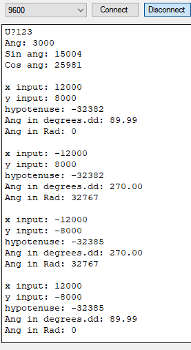

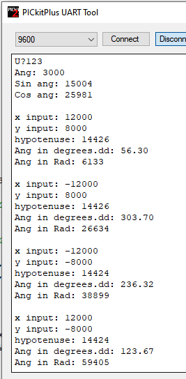

    Results of the 18F26K22 code running on a 18F26K22:

    (Erroneous) Results of the 18F26K83 code running on a 18F26K83:
    I've also attached my slightly modifed Trig18.inc file - only modified to allow the use of longs for PIC18s. Same inc file is used for both examples.

    Dec 2010
    Melbourne Australia
    172
    Default Re: Erroneous mathematical processing?
    Richard,
    Thanks for the tip. I've modified my trig file accordingly. Alas though, it didn't fix the issue with the ...K83 though.
    Troy

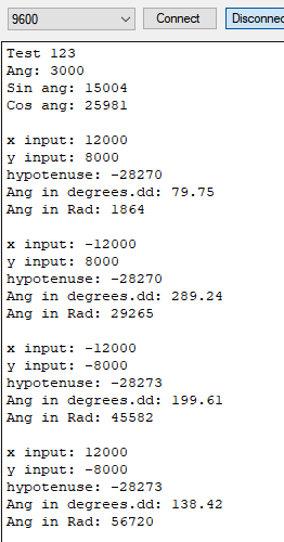

    2,722
    maybe a config issue , there is not much i can see that would not work in the asm stuff unless the 8x8 mult works differently
    you could try this , clutching at straws
    the code just assumes bank0
    atan2_sqrt:
      banksel 0
      ; Initialize _ang to 0
      clrf _ang
      clrf _ang+1
    sin_cos:
     banksel 0
      ; Initialize _x to 18218
      movlw 0x2a
      movwf _x
      movlw 0x47
      movwf _x+1

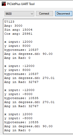

    Aug 2011
    461
    The K83 has its SFR registers located at the top of ram, and the common ones are in bank 63 ($3F00).
    The MOVFF instruction only uses 12-bits of addressing, so the highest address it can reach is $0FFF.
    To reach the upper registers past that you have to use the MOVFFL instruction instead. It's a 3-word instruction
    (vs 2 for MOVFF) that can reach the entire ram space. I mention that since that could require changing any
    jumps or gotos in the asm code as well.
    This would effect any code like the following:
        movff POSTINC0, PRODL
        movff POSTINC0, PRODH
    For the K83 (and K42) that would have to be:
        movffl POSTINC0, PRODL
        movffl POSTINC0, PRODH
    You also have to be using a version of MPASM that supports this instruction (MPASM v5.71 or later)

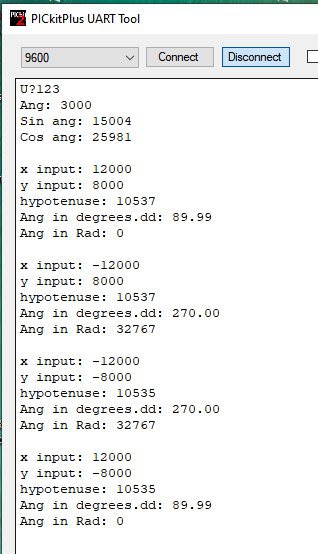

    2,722
    Thanks tumbleweed
    Troy try this
