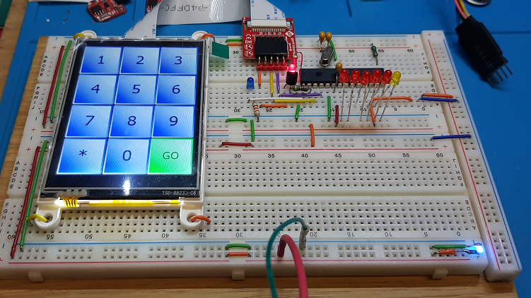

    Dear all,
    i need your help once again. I would like to replace the physical matrix 3x4keypad combination lock with a Digital touch screen display.
    I have for couple of years a display from 4D systems, 32DT which is a nice touch display. So i though i could add the digital 3x4 matrix keypad and retrieve the information for every key, via serial port and using this information, i could manage to make a simple combination code.
    Name:  4d combination lock.png
    The following is the information recieved for every key pressed. There is also 07Hex in front of all those numbers.
    As i read the datasheet of the Screen the actual value every number sent.....for example for the number 1 is 31hex.

    Hi Henrik and Richard.
    Many thanks for your prompt reply.
    Really i'm not comfortable with programming, and i try to do what i really understand.
    I think i solve the issue by changing the following lines to these.....
    chkey:
    if  portb.0 = 1 and portb.1 = 0 and portb.2 = 0 and portb.3 = 0 and portb.4 = 0 then return
    if  portb.0 = 1 and portb.1 = 1 and portb.2 = 0 and portb.3 = 0 and portb.4 = 0 then return
    if  portb.0 = 1 and portb.1 = 1 and portb.2 = 1 and portb.3 = 0 and portb.4 = 0 then return
    if  portb.0 = 1 and portb.1 = 1 and portb.2 = 1 and portb.3 = 1 and portb.4 = 0 then return
    if  portb.0 = 1 and portb.1 = 1 and portb.2 = 1 and portb.3 = 1 and portb.4 = 1 then pwok
    I wish i could manage to learn how to store values and read them after. I know that the code is not efficient at all.
    for now it works. I also change all the PORTX to LATX.
    In the mean time i will try to learn and understand how to right values, then store them, read them and compare.
    Many thanks once again.

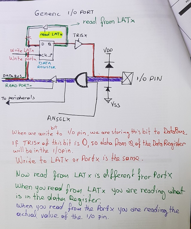

    EDIT: One more thing: You're clearly reading PORTB which must mean you're using those five low bits as inputs, yet, at the top of the program you have TRISB = %00000000 which makes all of PORTB outputs...
    So if you use for example the "if"
    if LATB.0 = 0
    that mean that we make the port as input? If that so, then what is the way to read the status of the port...."high" or "low" or even the value of the port?
    In the mean time im reading the manual.
    2,729
    Default Re: Digital touch Screen Combination lock
    if LATB.0 = 0
    combined with this continually showing up in your code
    TRISA = %00000000 'use TRISA to specify which pin is (1 = input) and which (0 = output) (ALL pins are output)

    leads me to think there is fundamental lack of understanding here of pic i/o architecture
    and the relation ship between ansel,port,lat and tris registers and their effect on
    pin operations.
    i would recommend a few led flashing exercises to become comfortable with i/o concepts

    nearly , pins configured as analogue always read as low
    these are my notes. I think i will try to understand why these happens.
    What i cannot understand is the writting to the portx or to latx.
    For example if we give alias:
    LED1 var LATX
    are we correspond the name to the LATX (not really writting to the LATX)
    So the same applies for the PORTX
    LED1 var PORTX
    The problem comes as i understand when we really write to the LATx or PORTx. Values are different.
    I need to do some exercises more on this.

    Oct 2010
    413
    On the diagram above the Flip flop....is it an edge triggered D flip flop?
    If so i will focus on the schematic and i will try to understand what is going on in there.

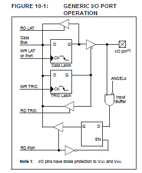

    when you write to lata you write directly to the porta output latches, only the pins declared as outputs are connected to the pins via the trisa "switch".
    when you write to porta you write directly to the porta output latches, only the pins declared as outputs are connected to the pins via the trisa "switch".
    when you read porta you read the digital logic level of all the porta pins , analog pins always read low
    when you read lata you read the porta output latches value not the digital logic level of all the porta pins
    when you write to a lata.pin you read the porta output latch value into the alu then,
    logically AND it with that pins bit value as 0 to CLEAR the pin
    or
    logically OR it with that pins bit value as 1 to SET the pin
    then write the result back to the porta output latches
    when you write to a porta.pin you read the porta pins value into the alu then,
    or
    if you did lesson one you would have noticed that port pins are subject to real world load conditions and that reading the pin value is not always what you wrote to it
    you need to allow for pin loading
    lesson two shows you can set and clear an analog pin made output but you can never read an analog pin properly
    lesson three shows you can read and write to output latches but they may not represent the pin values of that port they are always what you last wrote to the latch
    the diagram is for 1 pin
    Last edited by richard; - 18th August 2020 at 11:11. Reason: edited to English not gibberish

    ok i think i have some how understood the concept.
    my question is.
    How could we assign a value that can be stored in memory and represent the state of the pin itself. (0 or 1)
    but at the same time to not read the actual pin, but the value that is stored in memory.
    2,729
    simple, to read the value assigned to pins designated as output read latx its value is always what you last set it to
    the latx value of pins set as input is meaningless in regards to actual pin logic level
    to read the actual pin logic levels at a point in time read portx , its always the actual pin value at read time
    pin and latx values are not necessarily equal at a point in time, pins set as output are subject to real world physical constraints dictated by the load impedance they are driving

    i did a small test but it is not what i need.
    I would like now once again to clear the following.
    Henrik said
    "One more thing: You're clearly reading PORTB which must mean you're using those five low bits as inputs, yet, at the top of the program you have TRISB = %00000000 which makes all of PORTB outputs..."
    As this statement, how could we read the status of the actual pin without using the port as input. Could you please explain to me the method?
    ANSELA = 0
    simply put you cannot , reading portx is the only direct way to read the actual status of the pins.
    what henrik means is why would you read a port to read the value of outputs you have already set. the outputs will be at the level you set them to
    (after a suitable interval to allow pin to settle) {providing load is acceptable}.
    what are trying to do ?

    The program for the lockcode, at the moment works fine. As mentioned in my first post im not a programmer, i had to find a way to make it work.
    So the best suitable solution for me is to light up some LEDs and then read the status of the ports for confirmation.
    That's why i made those pins as output and then read the status to confirm if they are 0 or 1.
