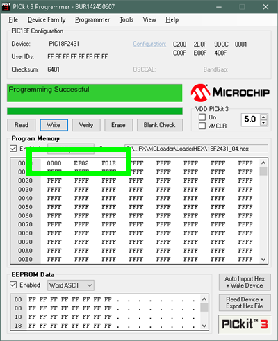

1.- I flashed my PIC via PICKit3 with le bootloader file from MCS ("18F2431_04.hex") and checked if it was really there; yes, it is in the PIC!
Name:  bootloader in PIC.png
...the rest of the code is way down in the memory - but it is there!

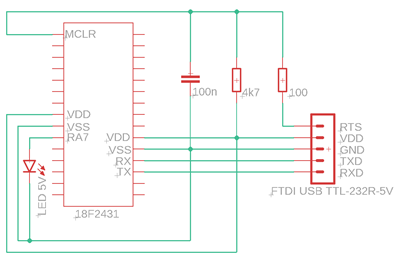

2.- I realised this serial programming circuit:
My FTDI cable is plugged in my PC and is "COM3".

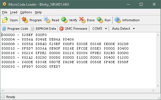

3.- I launched the Loader from within MCSP and loaded my "Blinky_18F2431.hex" file previously compiled:
4.- When I clic on "Program" in the Loader, I get following message:
Name:  error loader.png
Since I couldn't make it work, I tried to connect a button between MCLG and GND to make a "manual" reset but it doesn't help either.
There seems to be nothing to configure in the FTDI chip to activate/deactivate the RTS pin so I admit it is working.
Any clue what I'm doing wrong or missing?
