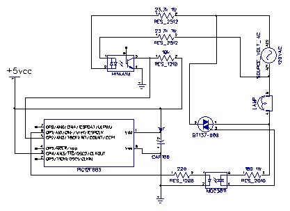

    Attachment 8898

    Can one of the mods change the title thread from "12F683 Light Dimmer Problem" to "12F683 Light Dimmer Problem (Solved)" I think that would be appropriate. Not sure if you can or not.

    So sorry on the original schematic I had the gate on the triac on the wrong pin. The gate is on pin 3 not pin 2

    Default Re: 12F683 Light Dimmer Problem (SOLVED)
    I see you have corrected the image, right?
    Jan 2008
    Pennsylvania
    113
    yes I corrected it and had to upload it again.
    CAP100 is showing the wrong polarity.
    Nice catch Jerson!
    Sorry about that strangely I could not find a non-polarized cap symbol and choose that one and forgot to flip it. Let me search in the program some more to see if I can find a non-polarized one. There are so many symbols mostly based on part numbers. Hard to find just general symbols.
    David
    I found one finally it's not in the CAP category either. thanks for catching that.
