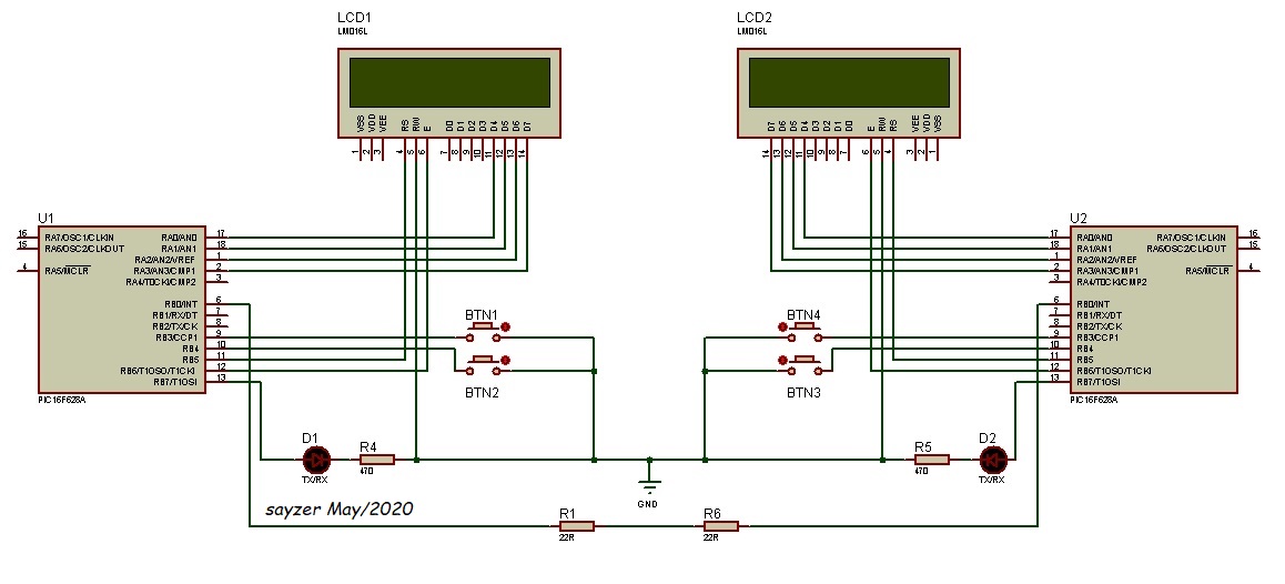

    For one pin bi-directional communication, without hardware serial port but with Serin and Serout soft commands; here is something to work on. Just a demo.
    I chose 628A for demo because of its popularity around;
    It can be any PIC (almost any).
    The circuit is for demo purposes only to show how the concept works.
    In real application, since this is a communication, a precision external crystal needs to be used and config fuse has to be changed.
    In this example, internal weak pull ups are used for buttons; and for comm pin idle state.
    If the PIC you use has no internal weak pull ups, then have 22K...100K resisitor connected to Vdd from these pins.
    Idea is to use RB0 int pin to detect incoming data pulse; sender (transmitter) first sends two zeros at the beginning of the package; Receiver side jumps into int routine and starts waiting for "ABX" header.
    Play as you wish.
