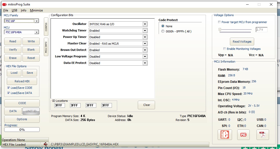

I could not get microcode studio to work with it - it does not seem to be able to find the board.
command line use for the mikro onboard icd doesn't seem to be a possibility, its not going to run from the msc button.
i just load the hex file manually , if you compile my code the config fuse settings are embedded in the hex file
there is no need to set them
