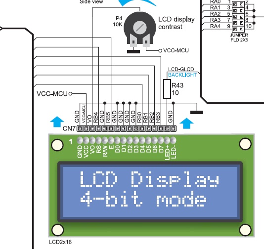

    i assume you ep6 is connected like this

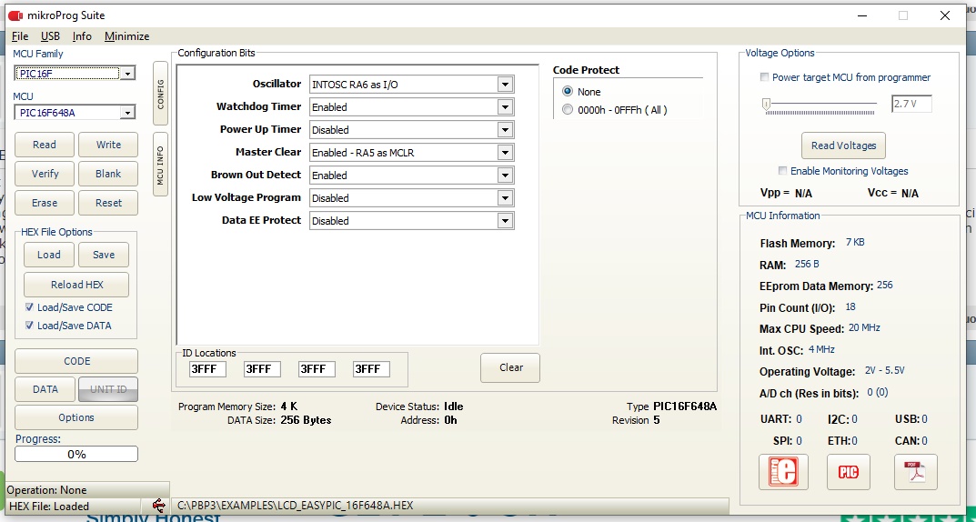

    I am using PBP 3.0.8.0 compiler with the mikroProg suite as my software. It lets you set the config bits when you load the hex file. My config bits set the oscillator as internal, watchdog timer enabled, power up disabled, master clear enabled, brown out detect enabled, low voltage program disabled, Data EE disabled. I can flash an LED so I know the PIC is good and everything is working on that end.

    My connections are just like you printed

    Could the fuse settings be an issue? What software do you use to program your Easypic7? I could not get microcode studio to work with it - it does not seem to be able to find the board.
    command line use for the mikro onboard icd doesn't seem to be a possibility, its not going to run from the msc button.
    i just load the hex file manually , if you compile my code the config fuse settings are embedded in the hex file
    there is no need to set them
    you could upgrade to 3.0.10 for free

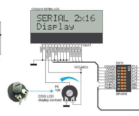

    just a thought , you're not trying to use the built in cog serial lcd are you ?
    Default Re: EasyPic 6 Mikroelectronika

    I think you have the defines for the LCD wrong. Have a look at the schematic in the user manual for the LCD. You will see that portb.0 to portb.3 is connected to the HIGH four data bits of the LCD.
    Change
    DEFINE LCD_DBIT 0
    to
    DEFINE LCD_DBIT 4
    Check that the LCD has power (I think you have to set a switch or jumper). Your LCD should burst into life.
