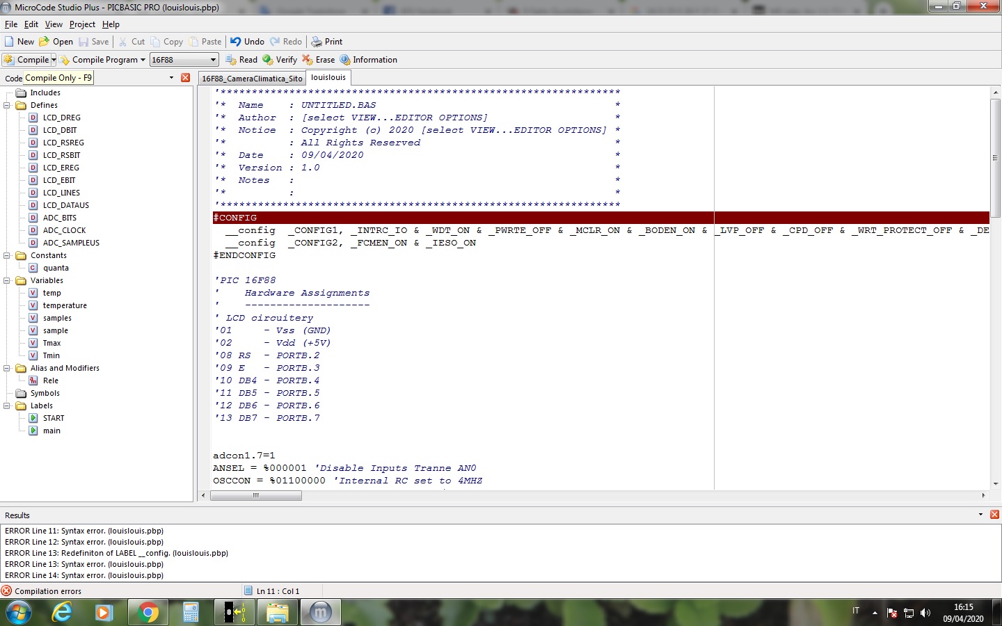

      __config  _CONFIG1, _INTRC_IO & _WDT_ON & _PWRTE_OFF & _MCLR_ON & _BODEN_ON & _LVP_OFF & _CPD_OFF & _WRT_PROTECT_OFF & _DEBUG_OFF & _CCP1_RB0 & _CP_OFF
      __config  _CONFIG2, _FCMEN_ON & _IESO_ON
    without too much hesitation, however, I did copy and paste of your source in my compiler
    Microcode Studio Plus 3.0.0.5
    and as soon as I tried to issue the compile command it gave me errors.
    ERROR Line 11: Syntax error. (louislouis.pbp)
    ERROR Line 12: Syntax error. (louislouis.pbp)
    ERROR Line 13: Redefiniton of LABEL __config. (louislouis.pbp)
    ERROR Line 13: Syntax error. (louislouis.pbp)
    ERROR Line 14: Syntax error. (louislouis.pbp)
    What are all those strings? why won't my compiler accept them?

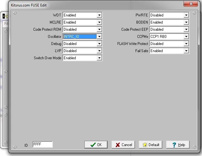

    Yes, compile without problems
    If I understand correctly, that's what I do when programming the chip, I set the fuses like this

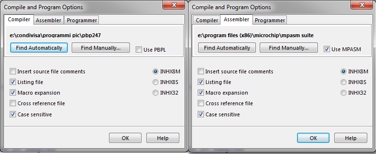

    First you compile in MCSP and then take the compiled HEX file and program to PIC with your picprogrammer? Or? How you program the PIC?
    It was a long time since I worked there, I pulled out old tools because I stopped at work for the "Corona Virus" and I wanted to have some fun.
    Some time ago I used a self-built ProPic2, which went on parallel port.
    Now that I no longer have the parallel port, I bought a K150 on the internet. This mounts on USB.
    1) I write the code in MicroCode
    2) the MicroCode settings are these

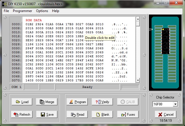

    3) I take the .Hex file
    4) I load the firmware for download on this program:
