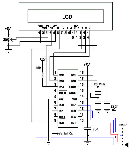

    Hi Guys
    This was pretty easy to share since it’s literally the schematic out of the manual, except 20 MHz clock, and has a serial input.
    I was looking for a simple serial terminal display project, even though a character LCD would be hopeless for a lot of applications,
    I wanted something simple, just to show some data is coming in.
    This is specifically intended for monitoring APRS packet data (Amateur Radio), but could easily be adapted to something else.
    It receives up to 60 bytes for a line, and is currently terminated with line feed 0x0A. This could be changed to return 0x0D.
    The first 20 characters are printed to LCD, and subsequent lines push the top line down (with no line wrapping).
    LCD graphics demo code is used for the intro, which is pixel based (not just rolling odometer effect), was done in 2013,
    and adjusted to work with this. A lot of functionality from the original demo code is removed to suit this program.
    Fancy Intro:
    Serial terminal - video made prior to intro being finished:

    and some code.
    16F628A with MCLR disabled, 20 MHz clock, and watchdog time left on.

    slug = px - 16
    IF lind+pind < 51 THEN ' range check
    temp = serrec[lind+pind]
    FOR CW = 0 TO 7
    IF slug = CW THEN
    temp.bit7 = 1
    wtemp = wtemp << 1
    NEXT CW
    serrec[lind+pind] = tempb
    writecg:	' size, ram and performance win for V2
    L0 = $40	' reset lines
    FOR CL = 0 TO 7 ' write first half of display
    FOR CW = 0 TO 3
    rolls[CW] = (serrec[0] ^ invert) >> 3
    gosub Rotate
    NEXT CW
    gosub lcdgfxchunk
    NEXT CL
    FOR CW = 0 TO 23 ' skip invisible line
    gosub RotateDisplay
    NEXT CW
    if demo = 0 then 'not for rolling odometer
    L0 = $60	' reset lines
    FOR CL = 0 TO 7 ' write second half of display
    FOR CW = 0 TO 3
    gosub Rotate
    NEXT CW
    gosub lcdgfxchunk
    NEXT CL
    ' draw to LCD
    LCDOUT $FE,$80	'draw first line of display
    FOR CL = 0 TO 4
    LCDOUT 0,1,2,3	'
    NEXT CL
    LCDOUT $FE,$C0	'draw second line of display
    FOR CL = 0 TO 4
    LCDOUT 4,5,6,7	'
    NEXT CL
    if demo = 1 then ' digits on one display area only
    LCDOUT $FE,($80+12)	'draw first line of display
    LCDOUT 0,1,2,3
    Rotate:									' the only assembler routine
    gosub rota								' needed for speed
    rota:									' by neglecting to carry the
    gosub RotateDisplay						' status bit, it also clears
    gosub RotateDisplay						' the buffer for the next frame
    RotateDisplay:							' bitwise rotate array right
      @ rlf 	_serrec+50		,F				; ditching the first bit
      @ rlf 	_serrec+49		,F				;
      @ rlf		_serrec+48		,F				;
      @ rlf		_serrec+47		,F				;
      @ rlf		_serrec+46		,F				;
      @ rlf		_serrec+45		,F				;
      @ rlf		_serrec+44		,F				;
      @ rlf		_serrec+43		,F				;
      @ rlf		_serrec+42		,F				;
      @ rlf		_serrec+41		,F				;
      @ rlf		_serrec+40		,F				;
      @ rlf		_serrec+39		,F				;
      @ rlf		_serrec+38		,F				;
      @ rlf		_serrec+37		,F				;
      @ rlf		_serrec+36		,F				;
      @ rlf		_serrec+35		,F				;
      @ rlf		_serrec+34		,F				;
      @ rlf		_serrec+33		,F				;
      @ rlf		_serrec+32		,F				;
      @ rlf		_serrec+31		,F				;
      @ rlf		_serrec+30		,F				;
      @ rlf		_serrec+29		,F				;
      @ rlf		_serrec+28		,F				;
      @ rlf		_serrec+27		,F				;
      @ rlf		_serrec+26		,F				;
      @ rlf		_serrec+25		,F				;
      @ rlf		_serrec+24		,F				;
      @ rlf		_serrec+23		,F				;
      @ rlf		_serrec+22		,F				;
      @ rlf		_serrec+21		,F				;
      @ rlf		_serrec+20		,F				;
      @ rlf		_serrec+19		,F				;
      @ rlf		_serrec+18		,F				;
      @ rlf		_serrec+17		,F				;
      @ rlf		_serrec+16		,F				;
      @ rlf		_serrec+15		,F				;
      @ rlf		_serrec+14		,F				;
      @ rlf		_serrec+13		,F				;
      @ rlf		_serrec+12		,F				;
      @ rlf		_serrec+11		,F				;
      @ rlf		_serrec+10		,F				;
      @ rlf		_serrec+9		,F				;
      @ rlf		_serrec+8		,F				;
      @ rlf		_serrec+7		,F				;
      @ rlf		_serrec+6		,F				;
      @ rlf		_serrec+5		,F				;
      @ rlf		_serrec+4		,F				;
      @ rlf		_serrec+3		,F				;
      @ rlf		_serrec+2		,F				;
      @ rlf		_serrec+1		,F				;
      @ rlf		_serrec+0		,F				;
      @ bcf		_serrec+50		,0				;clear MSB
    printdigit:	'print a single graphic digit to screen
    index = dval * 8' set the index position for digit
    FOR L0 = 0 TO 6
    read (index-doff)+8,digit	'rolling odometer data
    FOR CL = 0 TO 4
    IF digit.bit4 = 1 THEN
    px = dgx+CL
    py = dgy+L0
    gosub setpixel
    digit = digit << 1
    NEXT CL
    index = index + 1
    NEXT L0
    cleararrays:
    sercnt = 0 ' reset to use as a counter
    while sercnt < 61
    serrec[sercnt] = 0	'clear serial receive buffer
    if sercnt < 40 then	'clear both display buffer lines
    larray[sercnt] = $20
    sercnt = sercnt + 1
    wend
    sercnt = 0
    printfourspaces:
    lcdout "    "
    lcdgfxchunk:	' program memory optimisation
    LCDOUT $FE,L0+$00,rolls[0]
    LCDOUT $FE,L0+$08,rolls[1]
    LCDOUT $FE,L0+$10,rolls[2]
    LCDOUT $FE,L0+$18,rolls[3]
    L0 = L0 + 1
    delays:
    @ clrwdt
    pause 660
    delayb:
    @ clrwdt
    pause 660
    @ clrwdt
    pause 660
    @ clrwdt
    checkfortime:
    qualify = 0 : digit = 0
    acount = sercnt	'used as a counter here
    while acount > 8
    acount = acount - 1
    if serrec[acount] = ":" && serrec[acount-1] = "@" then
    digit = acount-4 : acount = 0
    wend
    if digit > 0 then
    if serrec[digit-3] < $3A then	'extra sanity check
    if serrec[digit-3] > $2F then	'
    if serrec[digit] < $33 then
    lcdout $FE,$C0		'set second line position
    gosub printfourspaces
    lcdout "TIME: "	'start of time display line
    'convert to local time here
    cx = serrec[digit] - $30	'get real values
    cy = serrec[digit-1] - $30	'
    cx = cx * 10				'move to msd
    cx = cx + cy				'cx should be true value now
    cx = cx + 10				'convert to local eastern time
    if cx > 23 then				'fix possible overflow
    cx = cx - 24				'
    endif						'
    cy = cx/10					'split digits and convert back to ascii
    serrec[digit] = cy + $30	'most significant hour digit restored
    cx = cx - (cy*10)			'
    serrec[digit-1] = cx + $30	'least significant hour digit restored
    lcdout serrec[digit],serrec[digit-1],":",serrec[digit-2],serrec[digit-3]," " ' use z for zulu if not local time
