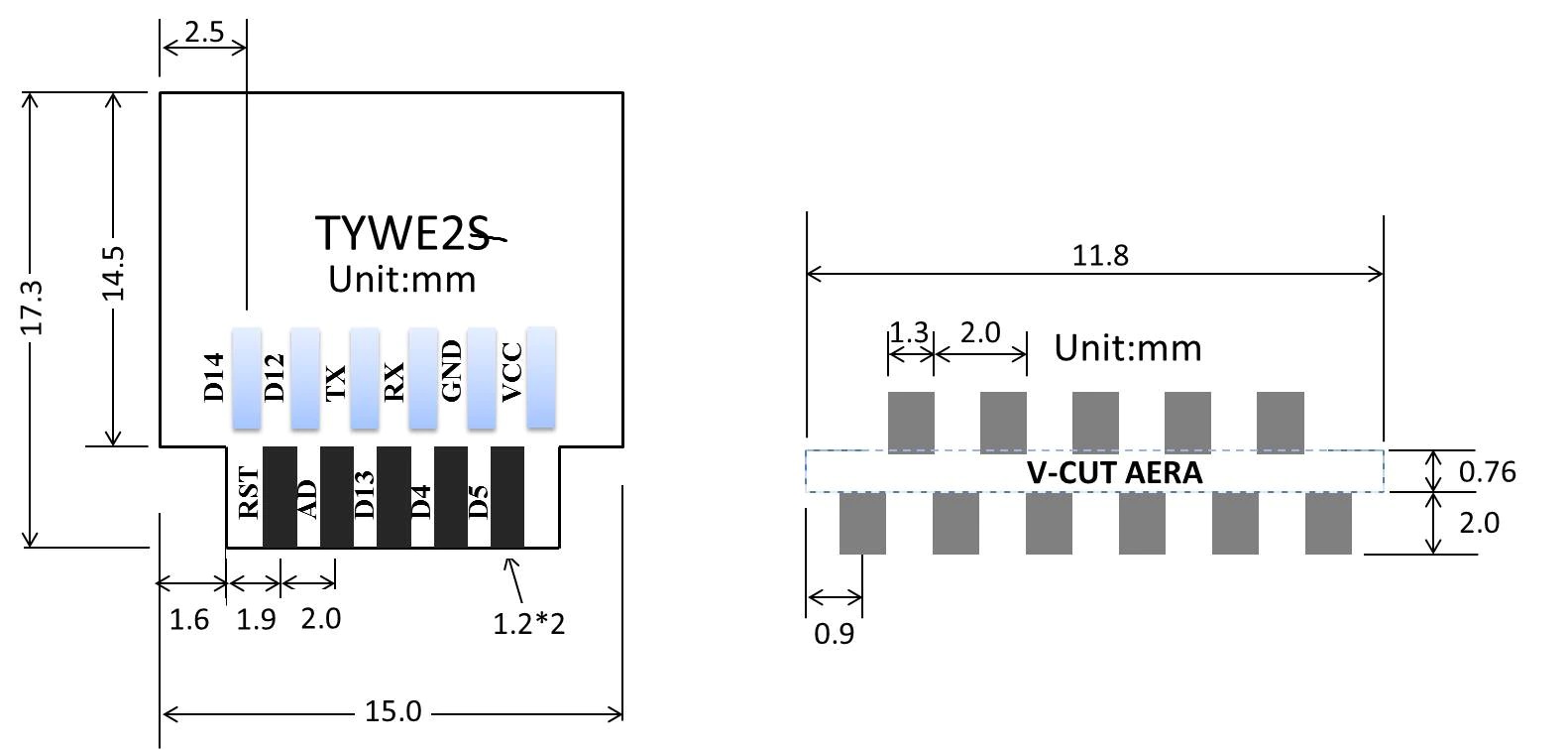

    my current educational project is a weather station webserver;
    pic16f18326 - 32k fram - bme280 - esp02s
    would love to find a socket to fit TYWE2S ESP8285 Module
    i was using the m3 but the price/availability ratio has soured
