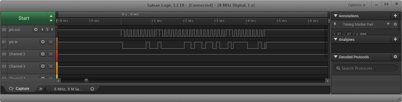

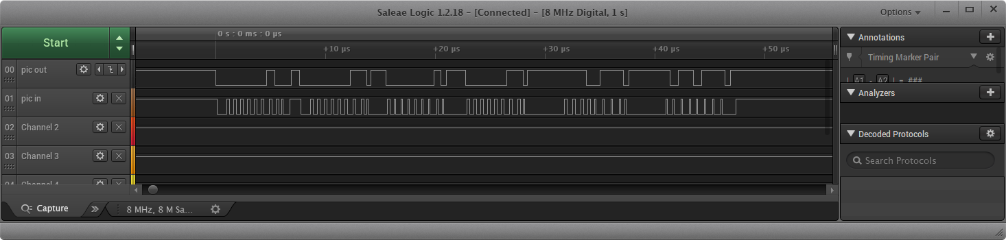

    your code is a bit glitchy and about 30 times too slow but it can work
    see difference in these pics
