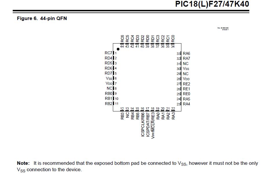

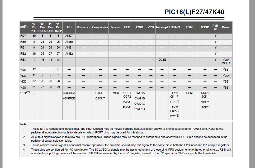

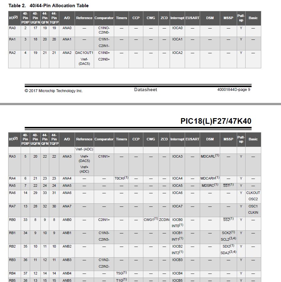

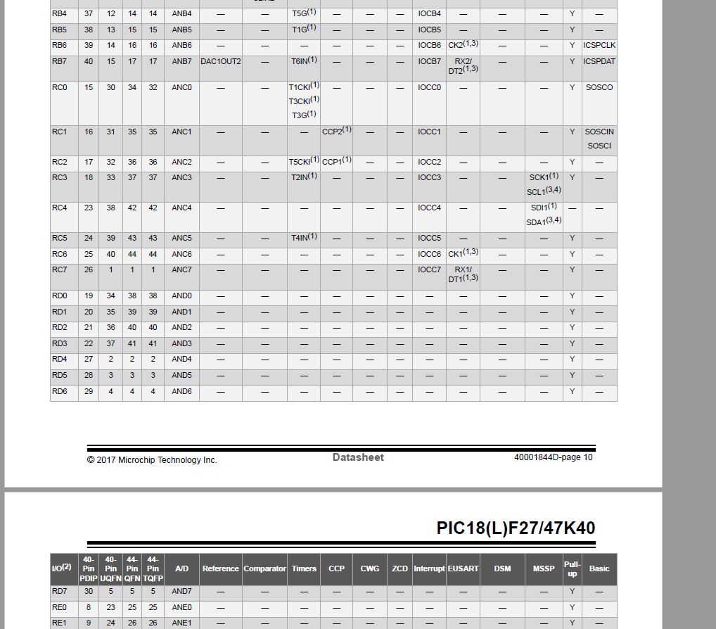

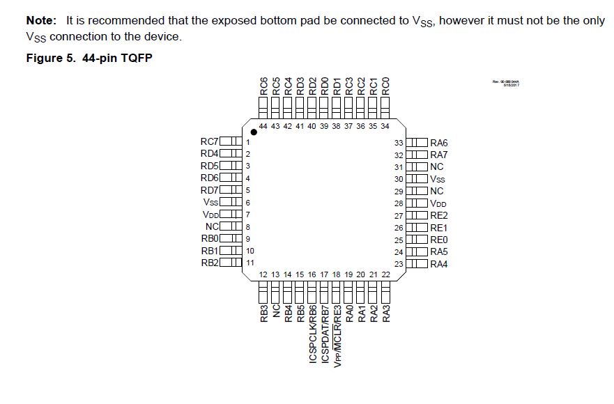

    here are the following discrepancies between the pin allocation table and Figures 5,6 of the 44 pin packages , if i missed something please let me know
    following are the discrepancies between the pin allocation table and the chip shown on FIG5, FIG6
    N/C - FIG 5,6 = PIN 31
    RA6 - PIN ALLOCATION - TABLE 2 = PIN 31,
    RA6 - FIG 5,6 = PIN 33,
    N/C - PIN ALLOCATION - TABLE 2 = PIN 33 ( pin not shown in table thus Must be N/C pin ),
    RA7 - PIN ALLOCATION - TABLE 2 = PIN 30,
    RA7 - FIG 5,6 = PIN 32
    N/C - FIG 5,6 = PIN 8
    RB0 - PIN ALLOCATION - TABLE 2 = PIN 8
    RB0 - FIG 5,6 = PIN 9
    RB1 - PIN ALLOCATION - TABLE 2 = PIN 9
    RB1 - FIG 5,6 = PIN 10
    RB2 - PIN ALLOCATION - TABLE 2 = PIN 10
    RB2 - FIG 5,6 = PIN 11
    RB3 - PIN ALLOCATION - TABLE 2 = PIN 11
    RB3 - FIG 5,6 = PIN 12
    RC0 - PIN ALLOCATION - TABLE 2 = PIN 32
    RC0 - FIG 5,6 = PIN 34
    N/C - PIN ALLOCATION - TABLE 2 = PIN 34 ( pin not shown in table thus Must be N/C pin )
    RC1 - PIN ALLOCATION - TABLE 2 = PIN 32
    RC1 - FIG 5,6 = PIN 35
    RC2 - PIN ALLOCATION - TABLE 2 = PIN 32
    RC2 - FIG 5,6 = PIN 35
    RD0 - PIN ALLOCATION - TABLE 2 = PIN 38
    RD0 - FIG 5,6 = PIN 39
    RD1 - PIN ALLOCATION - TABLE 2 = PIN 39
    RD1 - FIG 5,6 = PIN 38
    i have attached the datasheet details for checking
