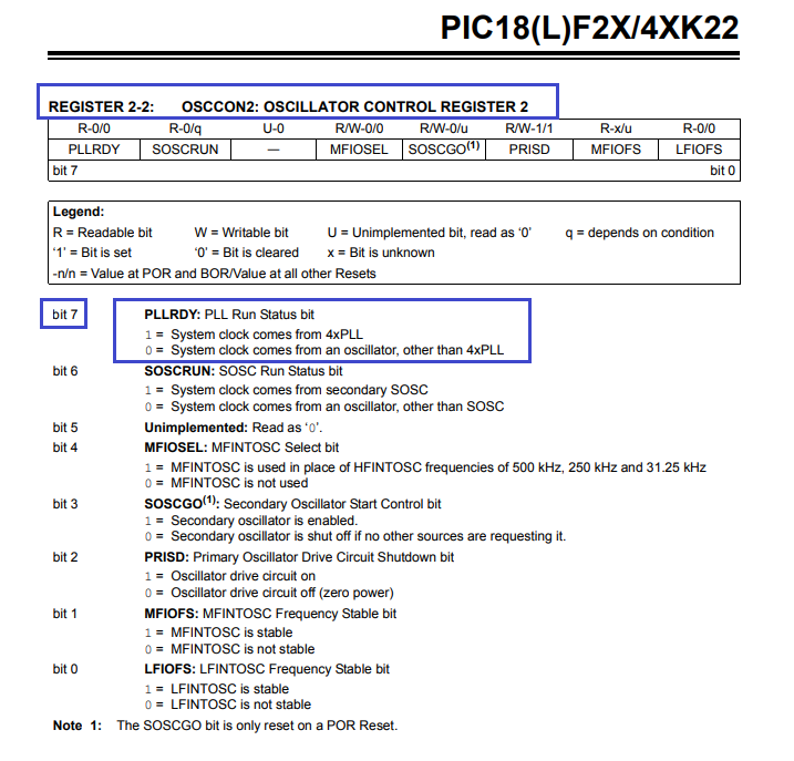

    From the manual it says that we need to enable the PLL bit and also specify that we are going to use the external OSC.
    I might need the help of the ones are most expirienced to help me out regarding the setting for 64 MHZ with an external crystal 16Mhz.

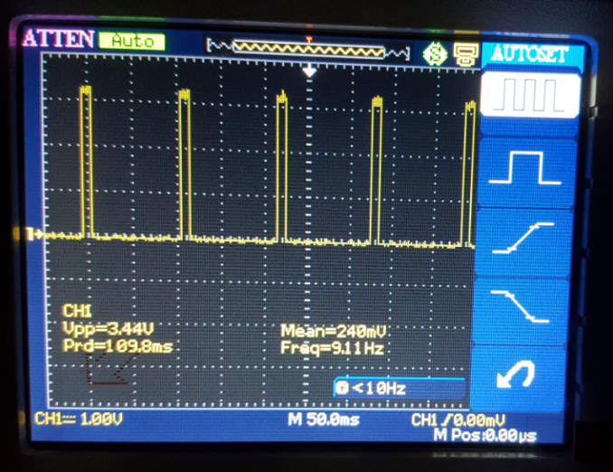

    Ioanni,
    thanks a lot for the help. I'll do it tonight and try to increase the time.
    To be honest i made many changing to the pause commands like : 10ms , 100ms, 1000ms, 2000ms. All seem to work fine.
    It would be a good practice to see how could we identify that the PIC clock now is running at 64Mhz?
    Is there any way to measure this with an Oscilloscope? I believe that this is a question have been asked many times.
    If someone could help me to identify the cpu clock speed of the PIC with the new setting of external 16Mhz crystal and 4xPLL, i can do the testing, and share the information step by step in here. If there is already posted an example like this i would like to have a look at it.
    thanks a lot.
