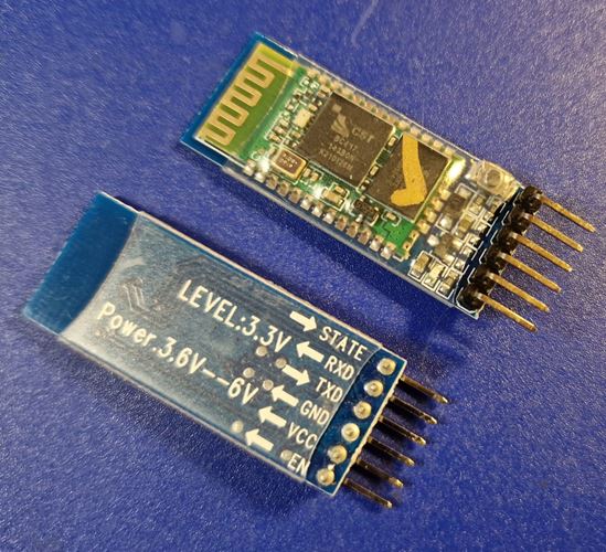

    After many hours of trying and trying again, none of my four HC05 modules are willing to accept the "Master" Role. I assume this is why I couldn't establish a serial link between them
    This is the most common example of HC05 modules configuration:
    ' Slave Configuration:
    ' AT+RMAAD (To clear any paired devices)
    ' AT+ROLE=0 (To set it as slave)
    ' AT+ADDR (To get the address of this HC-05, remember to jot the address down as it will be used during master configuration)
    ' AT+UART=9600,0,0 (To fix the baud rate at 9600)
    ' Master Configuration:
    ' AT+ROLE=1 (To set it as master)
    ' AT+CMODE=0 (To connect the module to the specified Bluetooth address and this Bluetooth address can be specified by the
    ' binding command)
    ' AT+BIND=xxxx,xx,xxxxxx (Now, type AT+BIND=98d3,34,906554 obviously with your respective address to the slave. Note the
    ' commas instead of colons given by the slave module)
    Every time I send the command AT+ROLE=1, the answer is OK but if I check with AT+ROLE, the answer is always +ROLE:0.
    I even found some information suggesting to have the MASTER role physically set with a jumper 3.3V <> Pin 28 or even 3.3V <> Pin 34, which I tried.
    https://www.martyncurrey.com/hc-05-f...-auto-connect/
    https://www.martyncurrey.com/arduino...odule-at-mode/
    But still nothing works...
    Is there a beam in my eye or can possibily all my four modules be malfunctioning? They're new....
    These are my modules:
Size:  32.6 KB Name:  HC05_Back.jpg

    Default Re: Bluetooth text file transfer from mobile phone to PIC - rookie's question
    Firstly, wishing all who read this post a happy and fruitful year ahead.
    I have used these modules. You need to ensure that the interface to the module works @3.3V not 5V. I just re-looked at my C code and see that there is zero initialisation that I have used with the modules. They natively connect akin to a serial UART and you can use a BT serial terminal to read/write to it. I have not used a single AT command in the code, and it works.

    I use FTDI USB cables that have 5V power and 3.3v UART levels so it should be okay from this side.
    I finally ordered new and different (looking) HC05 modules.
    These ones have two almost equally sized black chips unlike the ones I have on my desk so they might be a little différent.
    So wait and see...

    Default Bluetooth text file transfer from mobile phone to PIC - rookie's question
    Just received the "new" modules and guess what?
    Name:  2024-01-15 17_40_18-AI-Thinker Serial Tool V1.2.3.0    www.ai-thinker.com.jpg
    These are the ones I have now.
    I finally can start my tests
