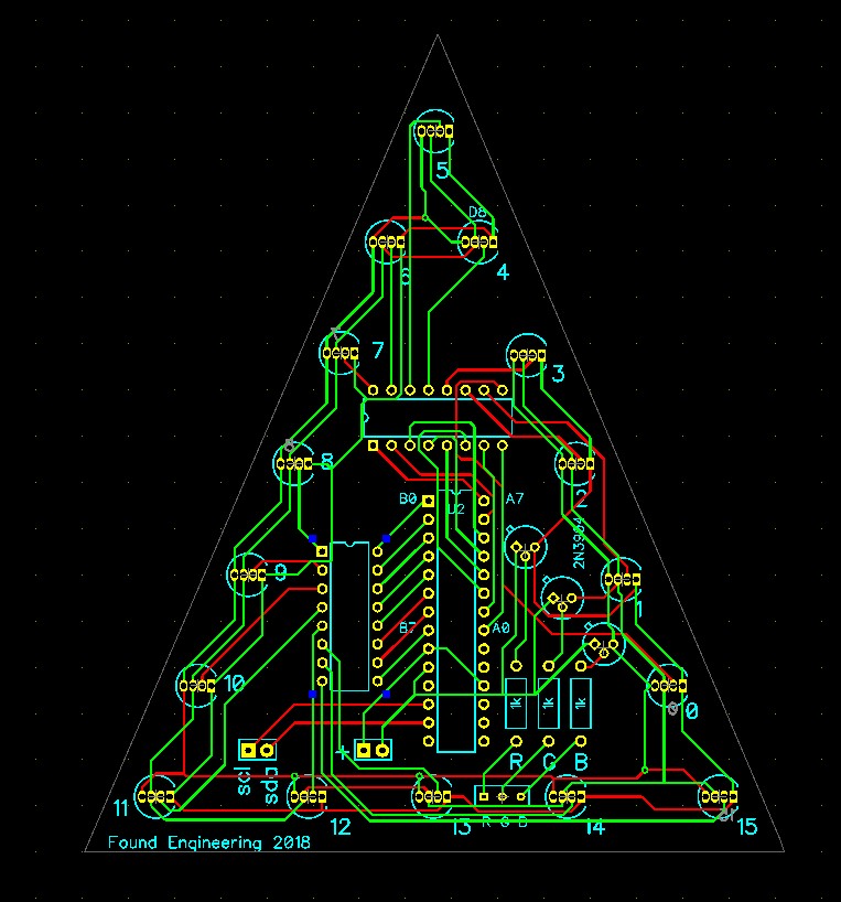

Size:  135.9 KB I have 5 of these RGB boards using the code below without issue, but I can't get a simpler version (the PBP code) with monochrome LEDs working.

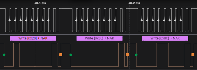

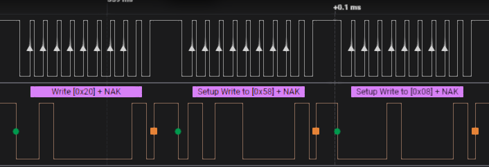

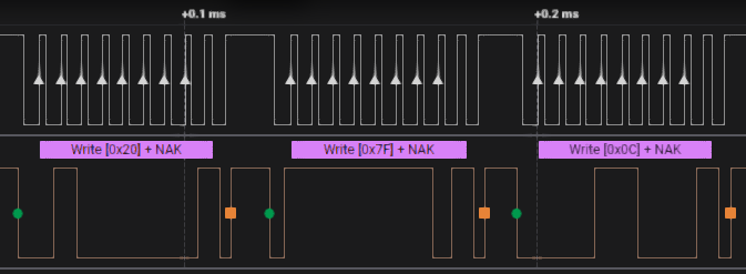

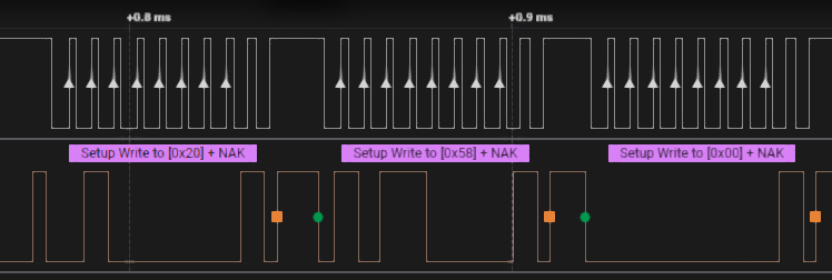

    This is what I get on SDA and SCL with that short program.
    Jun 2011
    Indian Harbour Nova Scotia
    108
    Default Re: more i2c and mcp23017
    I put a label at the end of my i2C write statement to flash an LED if there is no acknowledge from the chip.
    there is NO acknowledge...the LED is flashing. So that's a result I will work with. I have extra port expanders (all pretested) and 16F887s.
    Update:
    Changed out port expanders: no change
    Changed out 16F887: no change
    Changed SDA and SCL port from PortC.4 and PortC.3 to PortA.5 and PortA.4: works. Acknowledge led is OFF>
    Any insight into why PortC didn't work but PortA does? ON the LabX1, C.4 and C.3 are designated for I2C.

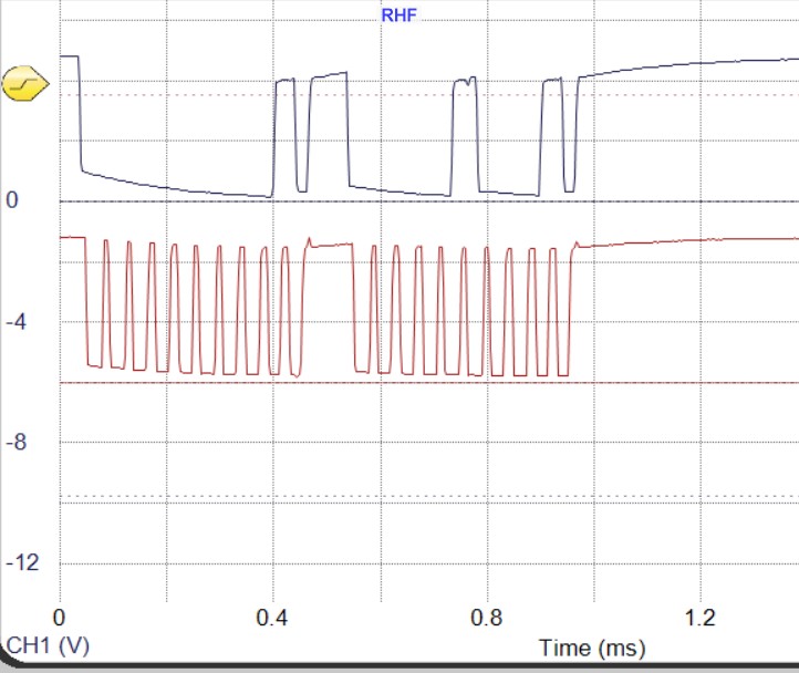

    Logic Probe readings of SCL/SDA lines.

                           ' Image 1
        I2CWRITE PinSDA2,PinSCL2,addr,[IOCONAreg,IOCONdat]
        I2CWRITE PinSDA2,PinSCL2,addr,[IODIRAreg,IODIRdat]
        pause 50
                           ' Image 2
        I2CWRITE PinSDA2,PinSCL2,addr,[IOCONBreg,IOCONdat]
        I2CWRITE PinSDA2,PinSCL2,addr,[IODIRBreg,IODIRdat]
    LOOOP:                 ' Image 3
        GPIOdat    = %00000000                             ' LEDs OFF
        I2CWRITE PinSDA2,PinSCL2,addr,[GPIOAreg,GPIOdat]
        I2CWRITE PinSDA2,PinSCL2,addr,[GPIOBreg,GPIOdat]
        pause 200
                           ' Image 4
        GPIOdat    = %11111111                             ' LEDs ON
        pause 400
        GOTO LOOOP
    Image 1:
    Name:  I2C IOCONa.png
    Image 2:
    Name:  I2C IOCONb.png
    (next 2 images in next post)
    Weird how 2 statements generate 3 groups of pulses (I expected 1 to 1 ratio).
    Image 3:
    Name:  I2C LEDoff.png
    Image 4:
    Name:  I2C LEDon.png
    Yup, reset, a0, a1 and a2 pulled down.
    Typo? RESETn is a low-active input so it wants a pullup, not pulldown...
    The traces show you're getting a NAK to the first byte (chip address), so that needs to get fixed before anything else.
    ...RESETn is a low-active input so it wants a pullup...
    ...insert facepalm emote here...
    Who knows how long this thing has been working.
    Weeeeee!
