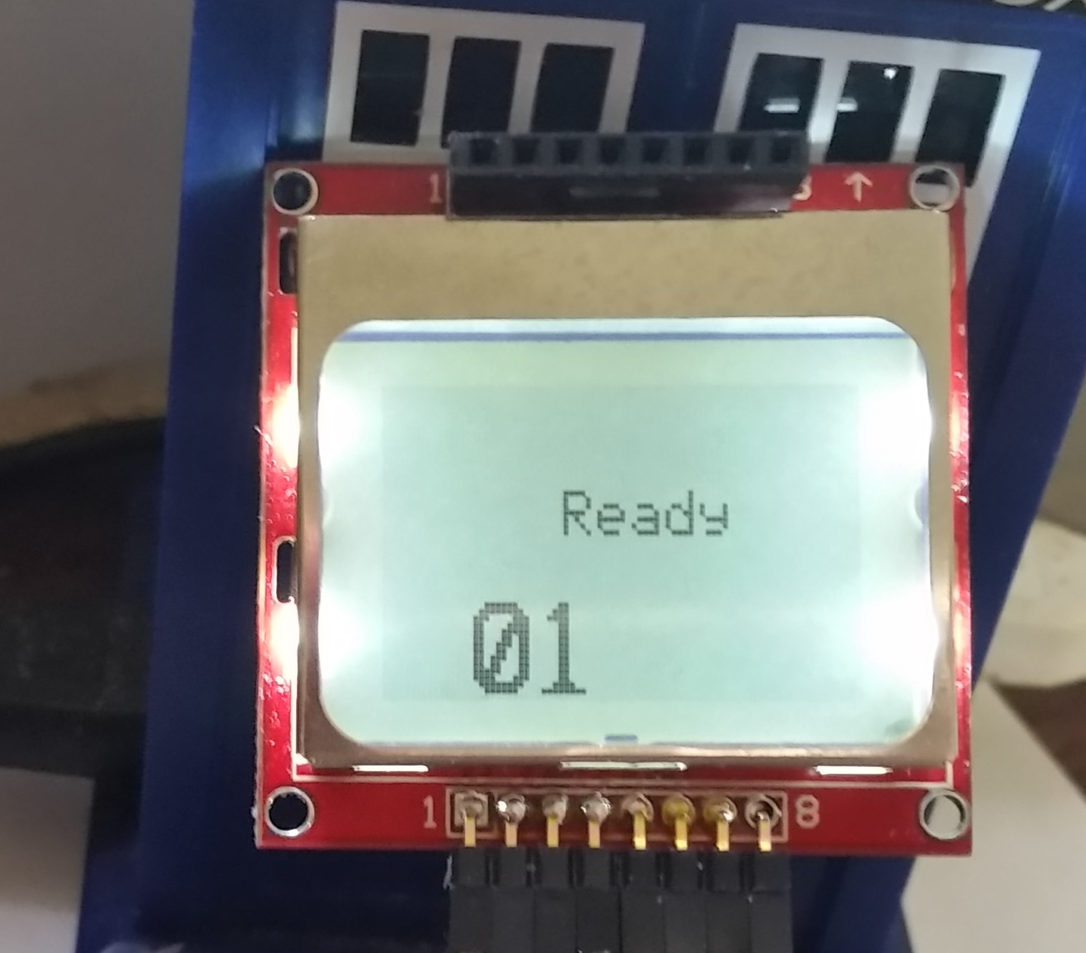

    a version with fonts of user defined size
    this has a 14x10 font for two char 0,1 ie 2 rows 10 columns
    fonts now have a header added to define rows/columns first chr and last chr
    eg
    #asm
    psect FONT_table,class=CODE,local,delta=2
      GLOBAL _FNT
    _FNT
            DW 0X0501, 0X207F  //1 ROW 5 COL CHR 32-127
            DW 0x0000, 0x0000, 0x0000, 0x005F, 0x0000 //  32 ' '  '!'
            DW 0x0007, 0x0007, 0x0014, 0x3F94, 0x3F94 //  34 '"'  '#'
            DW 0x122A, 0x3FAA, 0x0923, 0x0988, 0x3262 //  36 '$'  '%'
            Product Revision  :  PIC10 / PIC12 / PIC16 / PIC18 MCUs - 1.65.2
            Device            :  PIC16F1847
            Driver Version    :  2.00
     * font.c included via ide source files
    #include "mcc_generated_files/mcc.h"
    void putwreg(char work);
    void putcmd(char x);
    void WrChar(char );
    void WrStr(const char *);
    void set_fnt(const char *);
    extern const char FNT,NUM;
    uint16_t fnt_addr;
    char fnt_row,fnt_col,fnt_fc,fnt_lc,POSX,POSY;
    void main(void) {
        // initialize the device
        SYSTEM_Initialize();
        set_fnt(&FNT);
         *  initialize Nokia 5110 LCD display                                *
        __delay_ms(30); //
        LCD_RST_SetLow(); // 5110 'reset' pulse
        __delay_ms(1);
        LCD_RST_SetHigh(); // 5110 'reset' pulse
        __delay_ms(1);
        putcmd(0x20 + 0x01); // function set: extended instructions
        putcmd(0xc8); // set Vop (contrast), 0..127
        putcmd(0x04 + 0x02); // set temperature coefficient, 0..3
        putcmd(0x10 + 0x03); // Set bias system, 0..7
        putcmd(0x20 + 0x00); // function set: standard instructions
        putcmd(0x08 + 0x04); // display control: normal mode
        putcmd(0x80 + 0x20); // set DDRAM X address, 0..83
        putcmd(0x40 + 0x02); // set DDRAM Y address, 0..5
        POSX=32;
        POSY=2;
        WrChar('R'); // write ascii character
        WrStr("eady");
        set_fnt(&NUM);
        putcmd(0x80 + 0x10); // set DDRAM X address, 0..83
        putcmd(0x40 + 0x04); // set DDRAM Y address, 0..5
        POSX=16;
        POSY=5;
        WrChar('0'); // write ascii character
        WrChar('1'); // write ascii character
        while (1) {
     End of File
    void set_fnt(const char *F){
        uint16_t tmp;
        fnt_addr=(uint16_t)F&0x1fff;
        tmp=FLASH_ReadWord(fnt_addr++);
        fnt_row = (char)tmp;
        fnt_col = tmp>>8;
        fnt_lc = (char)tmp;
        fnt_fc = tmp>>8;
    void putwreg(char work) // send byte, msb first (15 words)
        LCD_CE_LAT = 0; // spi enable on
        SPI1_Exchange8bit(work);
        LCD_CE_LAT = 1; // spi enable off
    void WrChar(char d) { // for packed 2.5 word 5x7 font
        uint16_t tmp, inx = fnt_addr;
        char fd[32], i = fnt_row, j = 0, k, *pt;
        if ((d < fnt_fc) || (d > fnt_lc))return;
        inx += ((d - fnt_fc) * fnt_col*fnt_row) >> 1;
        while (i--) {
            k = fnt_col >> 1;
            if (k == 2)k++;
            while (k--) {
                tmp = FLASH_ReadWord(inx++);
                if (!i)
                    fd[j + 1] = ((char)tmp & 0x7f) ;//<< 1
                    fd[j + 1] = ((tmp & 0x7f)<<1)&0xfe;
                tmp <<= 1;
                if (!i)
                    fd[j] = (tmp >> 8)& 0x7f;
                    fd[j] = (tmp >> 7)& 0xfe;;
                j += 2;
        pt = fd;
        if ((d & 1)&&(fnt_col == 5))pt++;
        i = fnt_row;
        while (i--) {
            k = fnt_col;
            putcmd(0x40 +POSY-i);
            if(!i){
                 putcmd(0x80 +POSX);
            // with font now stored in bufer fd its easy to have large and/or inverted text
            while (k--) {
                putwreg(*pt++);
            putwreg(0);
        POSX+=fnt_col+1;
    void putcmd(char x) {
        LCD_DC_SetLow();
        putwreg(x);
        LCD_DC_SetHigh();
    void WrStr(const char *buff) {
            while (*buff)
                WrChar(*buff++); //
    #asm
    psect nums_table,class=CODE,local,delta=2
    _NUM
            DW 0X0A02, 0X3031  //2 ROW 10 COL CHR 0,1
            DW 15998, 899 ,8691, 15775 ,16252     // chr 0x30 " 0 "
            DW 4031, 15486, 14307, 12400, 8095
            DW 0, 518, 16383, 0, 0                         // chr 0x31 " 1 "
            DW 64 ,8288 ,16383 ,12352, 8192

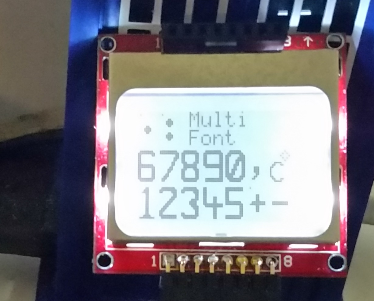

  4. #44
    2,729
    Default Re: Nokia lcd include , small footprint to suit pic16's

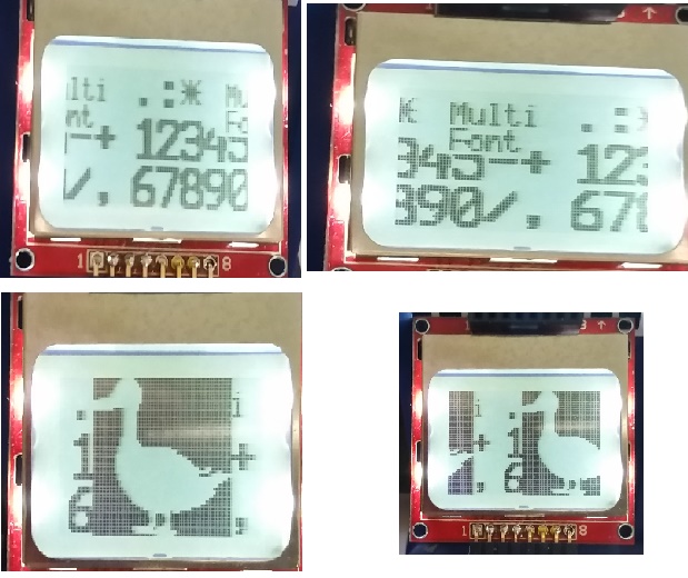

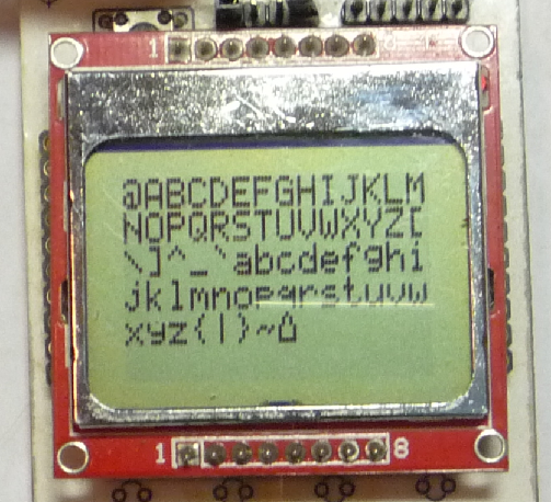

    some pics of the big fnt
  5. #45
    Aug 2005
    Michigan, USA
    224
    Nice work, Richard. This stuff is addicting...

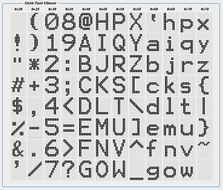

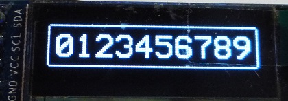

    I worked through my problems with XC8 and have put aside the "minimal overhead" 5x7 project for now (stopping at 370 words total). Now I'm lookin' at bigger fonts, too, and a driver that can use an hpos (0..83) and vpos (0..47) starting point for drawing characters.
    I looked at someone's 11x16 font (below left) but I don't like it as much as a 10x14 font from Noritake-Itron (below right). I think I'd like to use the Noritake font as a starting point and reduce the character size slightly to allow for descenders on a few select lower case characters.
    Take care... Have fun... Regards, Mike

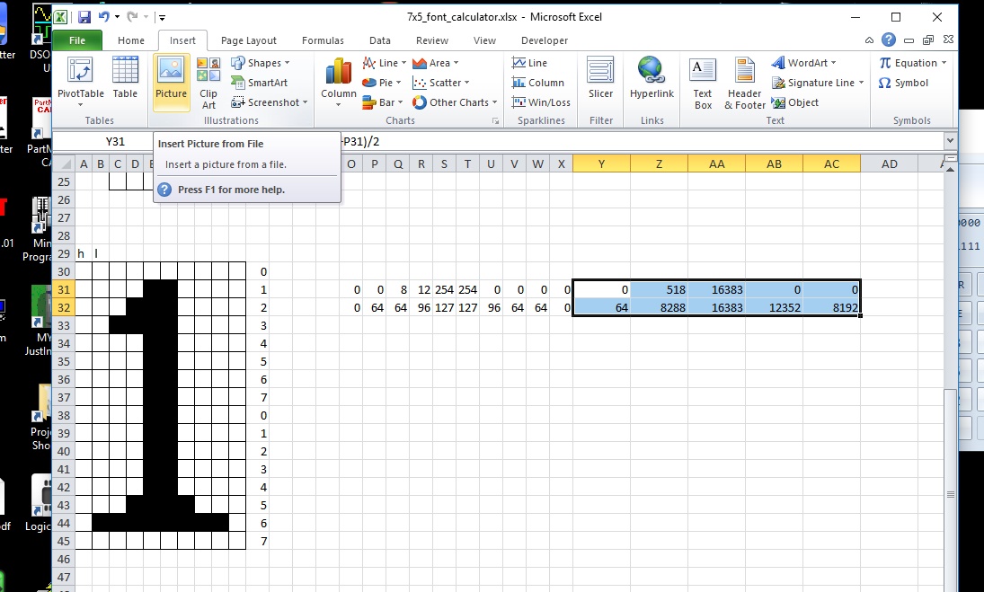

  6. #46
    4,184

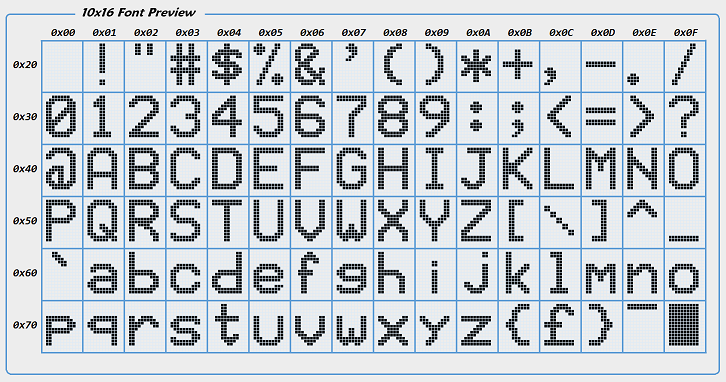

    May I ask for that magic excel file please?
  7. #47
    2,729
    all the magic is done with conditional formatting , a 1 in a field turns it black ,an empty field is blank
    make sure no field is greater than 1 or the math is incorrect
    complete number font

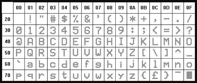

    I finally imported that Noritake 10x14 Font into Excel today. It took a bit of work. The Noritake Font file was 1920 separate "retlw 0x00" type lines. Not an ideal format for importing into Excel so I wrote a quick JustBASIC program to generate 96 lines with 10 comma separated words per line. After importing that file into Excel I discovered that Noritake maps the b15 bit to row 0 with the b0 bit all the way down at row 15 so I modified my JustBASIC program to exchange the bit order and finally got the Font into Excel. Whew!
    Name:  Font Viewer 10x14 (small).png
    '  Noritake 10x14 Font Table Converter    30-May-2018, Mike McLaren
    '  Reads the 1920 line one-hex-byte-at-a-time Noritake Font file and
    '  reformats it as 96 lines (one line per character), 10-words-per-line,
    '  reversed bit order (row 0 = bit 0), and as CSV text for Excel import.
    '  Does not alter the source file.
    '  Instructions
    '  1 - select the Noritake 10x14 text file from the File Dialog
    '  2 - output text displayed in console window
    '  3 - select text and copy to clipboard using <ctrl-C> or <edit> <copy>
    '  4 - paste into your spreadsheet (use text import tool)
    '  JustBASIC v1.01
       filedialog "Source File?", "*.txt", fileName$            '
       output$ = "hex"                                          ' select "dec" or "hex"
       if fileName$ <> "" then                                  '
         open fileName$ for input as #f                         '

    Richard, here's something fun... Someone over on the MrExcel forum helped me with a VBA macro that allows you to toggle the value in a cell within your 10x16 matrix between "null" and "1" by simply clicking on it. The attached file is your spreadsheet with macros enabled (xlsm rather than xlsx file extension). I'm not sure if you have to enable "developer" mode in Excel or not, but give it a try...
    Cheerful regards, Mike
    Private Sub Worksheet_SelectionChange(ByVal Target As Range)
    'Modified 5/30/18 9:50 PM EDT
    If Not Intersect(Target, Range("B30:K45")) Is Nothing Then
      If Target.Cells.CountLarge > 1 Then Exit Sub
        If Target.Value = "1" Then
          Target.Value = ""
        Else
          Target.Value = "1"
      End If
      Range("b28").Select
    End If
    End Sub

    thanks mike , its just whats needed and works perfectlty

    Ok, I'm almost ready to play with real hardware. I located my old 5110 display and an old 5110 test board that I had started to assemble (below). It looks like I need to solder a few wires onto the 8-pin 5110 connector. Maybe I can get this up-n'-runnin' this weekend...
    Are you running the PIC and 5110 display at 3.3 volts, Richard?
    yes the contrast won't accommodate 5v for me.
    I still have a bug in the bitmap routine, but my eldest son is getting married tomorrow so I have to play
    happy families

    Hi Richard,
    I finally found some time to try your suggestions as shown in post #41 - it does not work for me.
    Copying and pasting your code, I had no display until changing TRISA from %10010000 to all outputs and even then no big characters were seen until DTints and associated parts were commented out. Order of Includes made no difference.
    There's still a problem with the backlighting as well because it initially is dim then changes to a short duration pulse of bright background coincident with each LCDCLR command. No difference whether displaying big characters or not wrt these bright flashes. When I add LCD_LIGHT = 1 in the mix I have no text displayed.
    Any suggestions where I should go to from here?
    Thanks and regards,
    Bill
    my code as posted works perfectly for me , so I'm not sure what the problem is.
    if you post your latest code attempt and refresh my memory on how its connected I will have a look.
  21. #61
    2,729
    correct I failed to make the LCD_RST pin an output , all the "LCD" pins need to be digital outputs.
    my code did not work after a power cycle , the disp was keeping its config from previous code so resets never happened

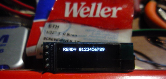

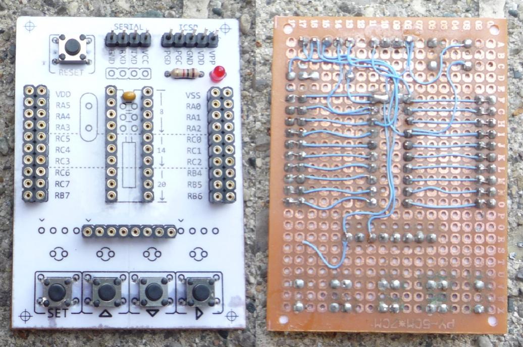

    Richard & gang... Just wanted to mention that my prototype board for the 5110 display works great and my "minimal" XC8 demo program ended up using 370 words of memory, including 240 words for the packed 5x7 font table.
    Also just got my little 128x32 SSD1306 I2C OLED display running with a 16F1823. Man, these OLED displays are really nice. A "bare bones" XC8 program + packed 5x7 font table uses 485 words of memory so a bit more 'overhead' for the low-level SSD1306 controller and I2C functions. However, the 2-pin interface more than makes up for the extra code (grin). Not sure how useful a 5x7 font will be on these little displays...
Size:  536.6 KBName:  SSD1306 #1.jpg

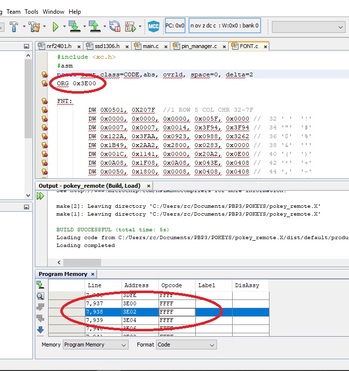

    Hi Richard.
    I threw a couple PSECT tables into an XC8 program for an 18F14K22 and when I look at the .LST file it seems XC8 is avoiding those tables just as it should.
     *   Digits '0' thru '9' of a 10x14 font                                *
       #asm
       PSECT my10x14, class=CODE, abs, ovrld, space=0, delta=2
         ORG 0x3E00
       Font10x14:
         dw 0x0FFC, 0x1FFE, 0x3F07, 0x3383, 0x31C3, 0x30E3, 0x3073, 0x383F, 0x1FFE, 0x0FFC  ;  48 '0'
         dw 0x0000, 0x0000, 0x300C, 0x300E, 0x3FFF, 0x3FFF, 0x3000, 0x3000, 0x0000, 0x0000  ;  49 '1'
         dw 0x300C, 0x380E, 0x3C07, 0x3E03, 0x3703, 0x3383, 0x31C3, 0x30E7, 0x307E, 0x303C  ;  50 '2'
         dw 0x0C0C, 0x1C0E, 0x3807, 0x3003, 0x3003, 0x30C3, 0x30C3, 0x38C7, 0x1FFE, 0x0F3C  ;  51 '3'
         dw 0x03C0, 0x03E0, 0x0370, 0x0338, 0x031C, 0x030E, 0x3FFF, 0x3FFF, 0x0300, 0x0300  ;  52 '4'
         dw 0x0C3F, 0x1C3F, 0x3833, 0x3033, 0x3033, 0x3033, 0x3033, 0x3873, 0x1FE3, 0x0FC3  ;  53 '5'
         dw 0x0FFC, 0x1FFE, 0x38C7, 0x30C3, 0x30C3, 0x30C3, 0x30C3, 0x39C7, 0x1F8E, 0x0F0C  ;  54 '6'
         dw 0x0003, 0x0003, 0x0003, 0x0003, 0x3FC3, 0x3FE3, 0x0073, 0x003B, 0x001F, 0x000F  ;  55 '7'
         dw 0x0F3C, 0x1FFE, 0x39E7, 0x30C3, 0x30C3, 0x30C3, 0x30C3, 0x39E7, 0x1FFE, 0x0F3C  ;  56 '8'
         dw 0x003C, 0x007E, 0x30E7, 0x30C3, 0x38C3, 0x1CC3, 0x0EC3, 0x07E7, 0x03FE, 0x01FC  ;  57 '9'
       #endasm
     *   Packed 96 character 5x7 Font, 2.5-words-per-character, 240 words   *
       #asm
       PSECT myFonts, class=CODE, abs, ovrld, space=0, delta=2
         ORG 0x3F00
       Font5x7:

    extract from .lst , it all looks good yet the font is not there.
     114                           	psect	text
       115  3E00                     	org	15872	;#
       116  3E00
       117                           ;#
       118  3E00  0501 207F          	dw	1281,8319	;#
       119  3E02  0000 0000 0000 005F 0000 	dw	0,0,0,95,0	;#
       120  3E07  0007 0007 0014 3F94 3F94 	dw	7,7,20,16276,16276	;#
       121  3E0C  122A 3FAA 0923 0988 3262 	dw	4650,16298,2339,2440,12898	;#
       122  3E11  1B49 2AA2 2800 0283 0000 	dw	6985,10914,10240,643,0	;#
       123  3E16  001C 1141 0000 20A2 0E00 	dw	28,4417,0,8354,3584	;#
       124  3E1B  0A08 1F08 0A08 043E 0408 	dw	2568,7944,2568,1086,1032	;#
       125  3E20  0050 1800 0008 0408 0408 	dw	80,6144,8,1032,1032	;#
       126  3E25  0060 3000 0020 0808 0202 	dw	96,12288,32,2056,514	;#

    That's wierd. The tables show up in the LST file and in the HEX file but not in the Program Memory window...
    Ok, section 6.2.9.3.4 in the XC8 User's Guide describes the PSECT "delta" parameter and as soon as I changed the parameters from "delta=2" to "delta=1" my two font tables showed up in the Program Memory window and my TBLPTR test code started working correctly in the simulator... Whew!
  35. #75
    2,729
    I agree , you would think writing word sized data would need delta=2.
    my brain hurts but it solves the problem , thanks mike

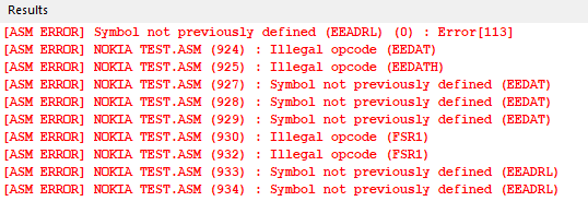

  40. #80

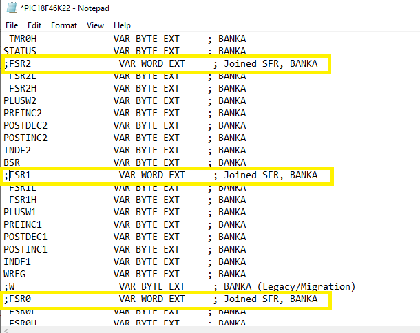

    Does it matter that SFR are commented in the pic18f46k22 pbpinc?
