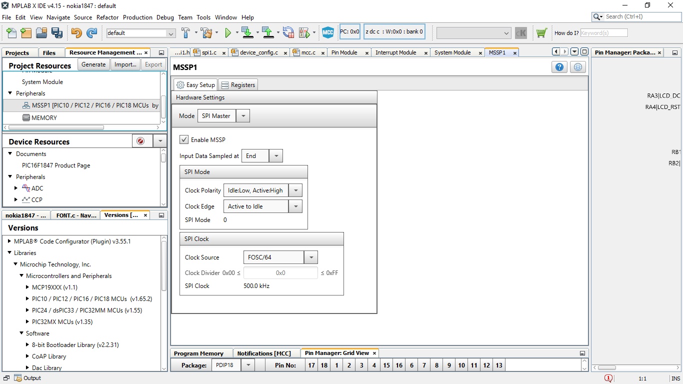

    if you really want to geek it up
    changing the output routine to use the mssp module shaves another 10% off the code size
    and speeds the thing up by a factor of 10x
    din and clk need to be on sdo and sck
    this
    PAUSEUS 150
    SHiftOUT LCD_DIN,LCD_CLK,1,[LcdData]
    becomes
    PIR1.3=0
    SSP1BUF = LcdData
    WHILE !PIR1.3 : wend
    and this is added to init routine
    SSP1CON1=$21 ;$22,21,20 all work @32mhz 20 is fastest
    SSP1STAT=$40

    Yes, I already thought about using the SPI module. The current bit-bang driver uses 14 words of memory and runs at ~190-kb/s (with 8-MHz clock). An SPI driver and its init code shouldn't be any bigger. I hope to work on an SPI driver later today. I just need to refresh my memory on the SPI modes. Looks like you're using CKE = 1 and CKP = 0, yes?

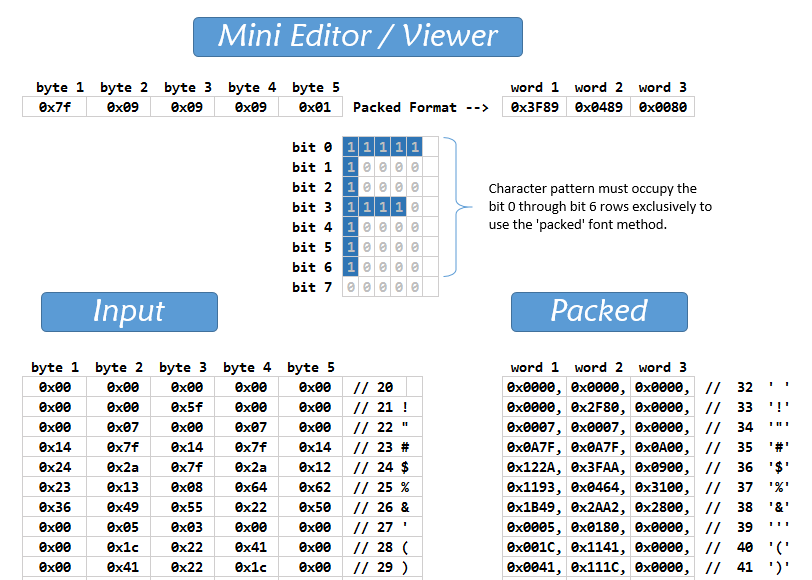

    I used a spreadsheet to convert my old 5 byte per character tables, too. Works a treat...

    I came up with the same solution , the freely available font creators [like the mikronta one] don't really
    convert the font to the most efficient format for pic's when codespace is an issue.

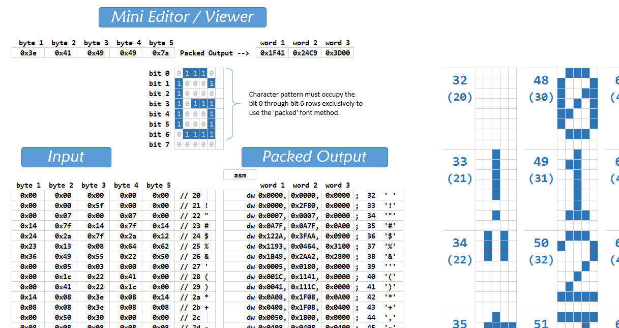

    Nice job on the spreadsheet, Richard. I just finished modifying mine to format the packed font table output for either C or asm. Here's a sample;

    I also decided to render all 96 characters directly from the input table so that I can see at-a-glance which characters might need tweaking...

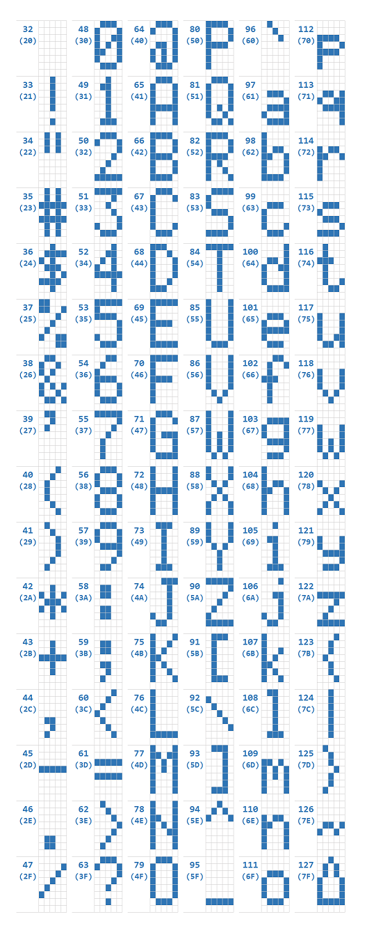

    Just finished the font render part of my spreadsheet. It renders directly from the unpacked 5-byte 'input' table. Change a byte in there and you'll see the changes immediately. Mind if I show it off, guys (see below)?
    Cheerful regards, Mike, K8LH

    thanks mike , the concept works nicely
    xc8 version (393)+240 words , uses mssp1

    void putwreg(char work) // send byte, msb first (15 words)
        LCD_CE_LAT = 0; // spi enable on
        SPI1_Exchange8bit(work);
        while (!PIR1bits.SSP1IF);
        LCD_CE_LAT = 1; // spi enable off

    I think I prefer my take on this
    since:-
    the font is automatically located
    the pin/hw defines are in mcc ,therefore its simple to port to any chip that can read its own flash
    its easy to debug
    bigtext and inverted text are easily implemented
    its only 100 or so words bigger
            Product Revision  :  PIC10 / PIC12 / PIC16 / PIC18 MCUs - 1.65.2
            Device            :  PIC16F1847
            Driver Version    :  2.00
     * font.c included via ide source files
