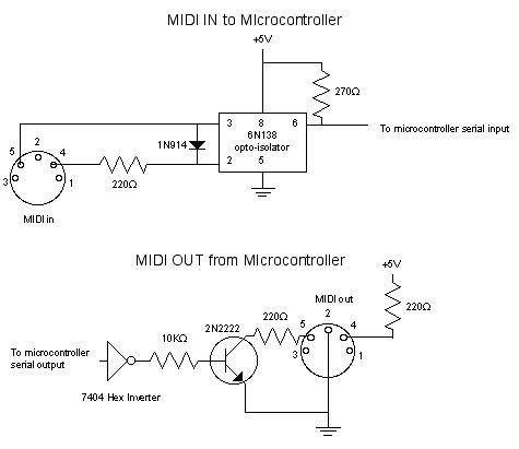

    Can you recommend something else that's better for connecting two PICs?
