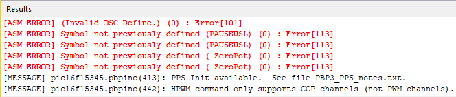

    Can't find anything on forum.
    The default config doesn't work, nor any of my attempts to fix it.
    Latest IDE, latest PBP Gold 3.1. Current Microchip everything.
    This board worked fine with a 18F13K22 but someone insisted we go to 16F15345.
    It has a 16Meg external oscillator and needs 4x PLL.
    __config _CONFIG1, _FEXTOSC_OFF & _RSTOSC_HFINT32 & _CLKOUTEN_OFF & _CSWEN_ON & _FCMEN_ON
    __config _CONFIG2, _MCLRE_ON & _PWRTE_ON & _LPBOREN_OFF & _BOREN_ON & _BORV_LO & _ZCD_OFF & _PPS1WAY_OFF & _STVREN_ON
    __config _CONFIG3, _WDTCPS_WDTCPS_11 & _WDTE_ON & _WDTCWS_WDTCWS_6 & _WDTCCS_HFINTOSC
    __config _CONFIG4, _BBSIZE_BB512 & _BBEN_OFF & _SAFEN_OFF & _WRTAPP_OFF & _WRTB_OFF & _WRTC_OFF & _WRTSAF_OFF & _LVP_OFF
    __config _CONFIG5, _CP_OFF
    It doesn't like the other type of config, either, returning: (Processor "16F15345" is invalid for CONFIG directive.)

    ASM ERROR] (Invalid OSC Define.) (0) : Error[101]
    ASM ERROR] Symbol not previously defined (PAUSEUSL) (0) : Error[113]
    is not a config error , the problem lies in the code not posted , somewhere an
    invalid OSC define exists

    What jumps out for me is you say you are using a 16 MHz external oscillator, yet in your CONFIG statement you list:
    Your CONFIG should have _FEXTOSC_EHC & _RSTOSC_EXT1X.
    Also, since you didn't post the rest of your code, I am taking a guess here. The 16F15345 has an SFR called OSCEN that allows you to turn ON different oscillators. Bit 7 enables your EXTernal OSCillator (EXTOSC), bit 6 enables your HFINTOSC you are using for your Watch Dog Timer (_WDTCCS_HFINTOSC in your CONFIG3).
    In my experience, the Compiler will generate totally non-related Errors at times. I would start here.

    You guys are right as usual. It had define OSC 64 for historical reasons.

    Yes, I posted the default. I tried lots of combinations but was trying to get this chip to run at 64 MHZ, when the max is 32.
